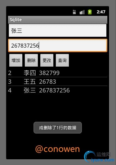

  下面演示一个以SQLite的数据库为adapter的listview例子(也可以当做通讯录小工具)
  效果图如下
/*主activity* @author:conowen* @date:12.3.1*/package com.conowen.sqlite;import android.app.Activity;import android.content.ContentValues;import android.database.Cursor;import android.database.sqlite.SQLiteDatabase;import android.os.Bundle;import android.view.View;import android.view.View.OnClickListener;import android.widget.Button;import android.widget.EditText;import android.widget.ListAdapter;import android.widget.ListView;import android.widget.SimpleCursorAdapter;import android.widget.Toast;public class SqliteActivity extends Activity {SQLiteDatabase sqldb;public String DB_NAME = "sql.db";public String DB_TABLE = "num";public int DB_VERSION = 1;final DbHelper helper = new DbHelper(this, DB_NAME, null, DB_VERSION);// DbHelper类在DbHelper.java文件里面创建的/** Called when the activity is first created. */@Overridepublic void onCreate(Bundle savedInstanceState) {super.onCreate(savedInstanceState);setContentView(R.layout.main);sqldb = helper.getWritableDatabase();// 通过helper的getWritableDatabase()得到SQLiteOpenHelper所创建的数据库Button insert = (Button) findViewById(R.id.insert);Button delete = (Button) findViewById(R.id.delete);Button update = (Button) findViewById(R.id.update);Button query = (Button) findViewById(R.id.query);final ContentValues cv = new ContentValues();// ContentValues是“添加”和“更新”两个操作的数据载体updatelistview();// 更新listview// 添加insertinsert.setOnClickListener(new OnClickListener() {@Overridepublic void onClick(View v) {// TODO Auto-generated method stubEditText et_name = (EditText) findViewById(R.id.name);EditText et_phone = (EditText) findViewById(R.id.phone);cv.put("name", et_name.getText().toString());cv.put("phone", et_phone.getText().toString());// name和phone为列名long res = sqldb.insert("addressbook", null, cv);// 插入数据if (res == -1) {Toast.makeText(SqliteActivity.this, "添加失败",Toast.LENGTH_SHORT).show();} else {Toast.makeText(SqliteActivity.this, "添加成功",Toast.LENGTH_SHORT).show();}updatelistview();// 更新listview}});// 删除delete.setOnClickListener(new OnClickListener() {@Overridepublic void onClick(View v) {// TODO Auto-generated method stubint res = sqldb.delete("addressbook", "name='大钟'", null);// 删除列名name,行名为“大钟”的,这一行的所有数据,null表示这一行的所有数据// 若第二个参数为null,则删除表中所有列对应的所有行的数据,也就是把table清空了。// name='大钟',大钟要单引号的// 返回值为删除的行数if (res == 0) {Toast.makeText(SqliteActivity.this, "删除失败",Toast.LENGTH_SHORT).show();} else {Toast.makeText(SqliteActivity.this, "成删除了" + res + "行的数据",Toast.LENGTH_SHORT).show();}updatelistview();// 更新listview}});// 更改update.setOnClickListener(new OnClickListener() {@Overridepublic void onClick(View v) {// TODO Auto-generated method stubcv.put("name", "大钟");cv.put("phone", "1361234567");int res = sqldb.update("addressbook", cv, "name='张三'", null);// 把name=张三所在行的数据,全部更新为ContentValues所对应的数据// 返回时为成功更新的行数Toast.makeText(SqliteActivity.this, "成功更新了" + res + "行的数据",Toast.LENGTH_SHORT).show();updatelistview();// 更新listview}});// 查询query.setOnClickListener(new OnClickListener() {@Overridepublic void onClick(View v) {// TODO Auto-generated method stubCursor cr = sqldb.query("addressbook", null, null, null, null,null, null);// 返回名为addressbook的表的所有数据Toast.makeText(SqliteActivity.this,"一共有" + cr.getCount() + "条记录", Toast.LENGTH_SHORT).show();updatelistview();// 更新listview}});}// 更新listviewpublic void updatelistview() {ListView lv = (ListView) findViewById(R.id.lv);final Cursor cr = sqldb.query("addressbook", null, null, null, null,null, null);String[] ColumnNames = cr.getColumnNames();// ColumnNames为数据库的表的列名,getColumnNames()为得到指定table的所有列名ListAdapter adapter = new SimpleCursorAdapter(this, R.layout.layout,cr, ColumnNames, new int[] { R.id.tv1, R.id.tv2, R.id.tv3 });// layout为listView的布局文件,包括三个TextView,用来显示三个列名所对应的值// ColumnNames为数据库的表的列名// 最后一个参数是int[]类型的,为view类型的id,用来显示ColumnNames列名所对应的值。view的类型为TextViewlv.setAdapter(adapter);}}
/*SQLiteOpenHelper类* @author:conowen* @date:12.3.1*/package com.conowen.sqlite;import android.content.Context;import android.database.sqlite.SQLiteDatabase;import android.database.sqlite.SQLiteDatabase.CursorFactory;import android.database.sqlite.SQLiteOpenHelper;public class DbHelper extends SQLiteOpenHelper {public DbHelper(Context context, String name, CursorFactory factory,int version) {super(context, name, factory, version);// TODO Auto-generated constructor stub}@Overridepublic void onCreate(SQLiteDatabase db) {// TODO Auto-generated method stubString sql = "CREATE  TABLE addressbook (_id INTEGER PRIMARY KEY , name VARCHAR, phone VARCHAR)";db.execSQL(sql);}@Overridepublic void onUpgrade(SQLiteDatabase db, int oldVersion, int newVersion) {// TODO Auto-generated method stub}}
