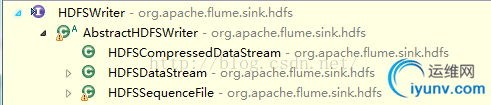

按照Flume的生命周期,先启动start方法:
  @Override
public void start() {
String timeoutName = "hdfs-" + getName() + "-call-runner-%d";
//线程池用于event写入HDFS文件
callTimeoutPool = Executors.newFixedThreadPool(threadsPoolSize,
new ThreadFactoryBuilder().setNameFormat(timeoutName).build());
String rollerName = "hdfs-" + getName() + "-roll-timer-%d";
//该线程池用来滚动文件
timedRollerPool = Executors.newScheduledThreadPool(rollTimerPoolSize,
new ThreadFactoryBuilder().setNameFormat(rollerName).build());
//该LinkedHashMap用来存储文件的绝对路径以及对应的BucketWriter
this.sfWriters = new WriterLinkedHashMap(maxOpenFiles);
sinkCounter.start();
super.start();
}所有的Event,经Source后发送的Channel,再由Channel传入到Sink,主要调用Sink的process方法实现事务:
public Status process() throws EventDeliveryException {
Channel channel = getChannel();//获取Channel
Transaction transaction = channel.getTransaction();//获取事务
List<BucketWriter> writers = Lists.newArrayList();//初始化BucketWriter列表,BucketWriter是操作HDFS主类。
transaction.begin();
try {
int txnEventCount = 0;
for (txnEventCount = 0; txnEventCount < batchSize; txnEventCount++) {//批量处理
Event event = channel.take();//获取Event
if (event == null) {
break;
// reconstruct the path name by substituting place holders
String realPath = BucketPath.escapeString(filePath, event.getHeaders(),
timeZone, needRounding, roundUnit, roundValue, useLocalTime);//格式化HDFS路径,根据转义字符
String realName = BucketPath.escapeString(fileName, event.getHeaders(),
timeZone, needRounding, roundUnit, roundValue, useLocalTime);//格式化文件名称,根据转义字符
//写入HDFS的绝对路径
String lookupPath = realPath + DIRECTORY_DELIMITER + realName;
BucketWriter bucketWriter;
HDFSWriter hdfsWriter = null;
// Callback to remove the reference to the bucket writer from the
// sfWriters map so that all buffers used by the HDFS file
// handles are garbage collected.
WriterCallback closeCallback = new WriterCallback() {
@Override
public void run(String bucketPath) {
LOG.info("Writer callback called.");
synchronized (sfWritersLock) {
sfWriters.remove(bucketPath);
//根据HDFS的绝对路径获取对应的BucketWriter对象
bucketWriter = sfWriters.get(lookupPath);

  public HDFSWriter getWriter(String fileType) throws IOException {
if (fileType.equalsIgnoreCase(SequenceFileType)) {
//通过SequenceFile.Writer写入文件
return new HDFSSequenceFile();
} else if (fileType.equalsIgnoreCase(DataStreamType)) {
//通过FSDataOutputStream
return new HDFSDataStream();
} else if (fileType.equalsIgnoreCase(CompStreamType)) {
return new HDFSCompressedDataStream();
} else {
throw new IOException("File type " + fileType + " not supported");
  HDFSSequenceFile:configure(context)方法会首先获取写入格式writeFormat即参数"hdfs.writeFormat",org.apache.flume.sink.hdfs.SequenceFileSerializerType定义了一下三个:
  Writable(HDFSWritableSerializer.Builder.class),//默认的
Text(HDFSTextSerializer.Builder.class),
Other(null);
再获取是否使用HDFS本地文件系统"hdfs.useRawLocalFileSystem",默认是flase不使用;然后获取writeFormat的所有配置信息serializerContext;然后根据writeFormat和serializerContext构造SequenceFileSerializer的对象serializer。
  HDFSDataStream:configure(context)方法先获取serializerType类型,默认是TEXT(BodyTextEventSerializer.Builder.class),其他的还包含:
