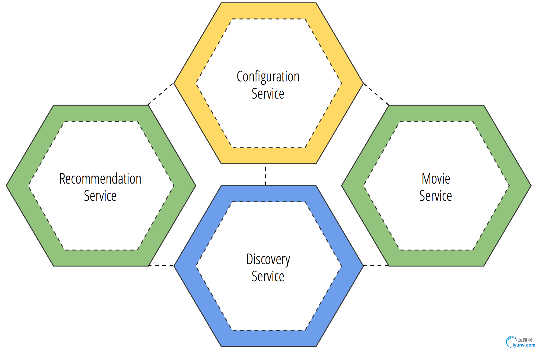

  Each service has a dedicated purpose in a microservices architecture. When building a microservices architecture on Spring Cloud, there are a few primary concerns to deal with first. The first two microservices you will want to create are the Configuration Service, and the Discovery Service.
  在微服务框架下,每个服务都只专注于一个目标。用Spring Cloud搭建微服务框架的时候,有几个先要处理的关键点。首先要创建的两个微服务是:配置服务(configuration service)和发现服务(discovery service)。
  The graphic above illustrates a 4-microservice setup, with the connections between them indicating a dependency.
  上面的图片演示了一个由4个微服务组成的系统,以及他们之间的依赖关系。
  The configuration service sits at the top, in yellow, and is depended on by the other microservices. The discovery service sits at the bottom, in blue, and also is depended upon by the other microservices.
  在最上面的黄色标记的配置服务(configuration service),被其他所有的微服务所依赖。最下面的蓝色标记的发现服务(discovery service),同样是被其他所有的微服务所依赖。
  In green, we have two microservices that deal with a part of the domain of the example application I will use throughout this blog series: movies and recommendations.
  绿色的两个微服务将会作为例子,贯穿整篇文章。他们分别提供电影播放和简介的服务。

  The configuration service is a vital component of any microservices architecture. Based on the twelve-factor app methodology, configurations for your microservice applications should be stored in the environment and not in the project.
  配置服务(configuration service)对所有微服务框架都是一个只管重要的组件。基于“12-factor app”方法论(附2),微服务应用程序的配置信息被保存在系统环境中,而不是工程文件里。
  The configuration service is essential because it handles the configurations for all of the services through a simple point-to-point service call to retrieve those configurations. The advantages of this are multi-purpose.
  配置服务(configuration service)很重要的原因是:通过一个简单的点对点服务调用,所有的服务就可以通过它获取自己的配置信息。这样做的好处就是:多用途(一次配置多处使用)。

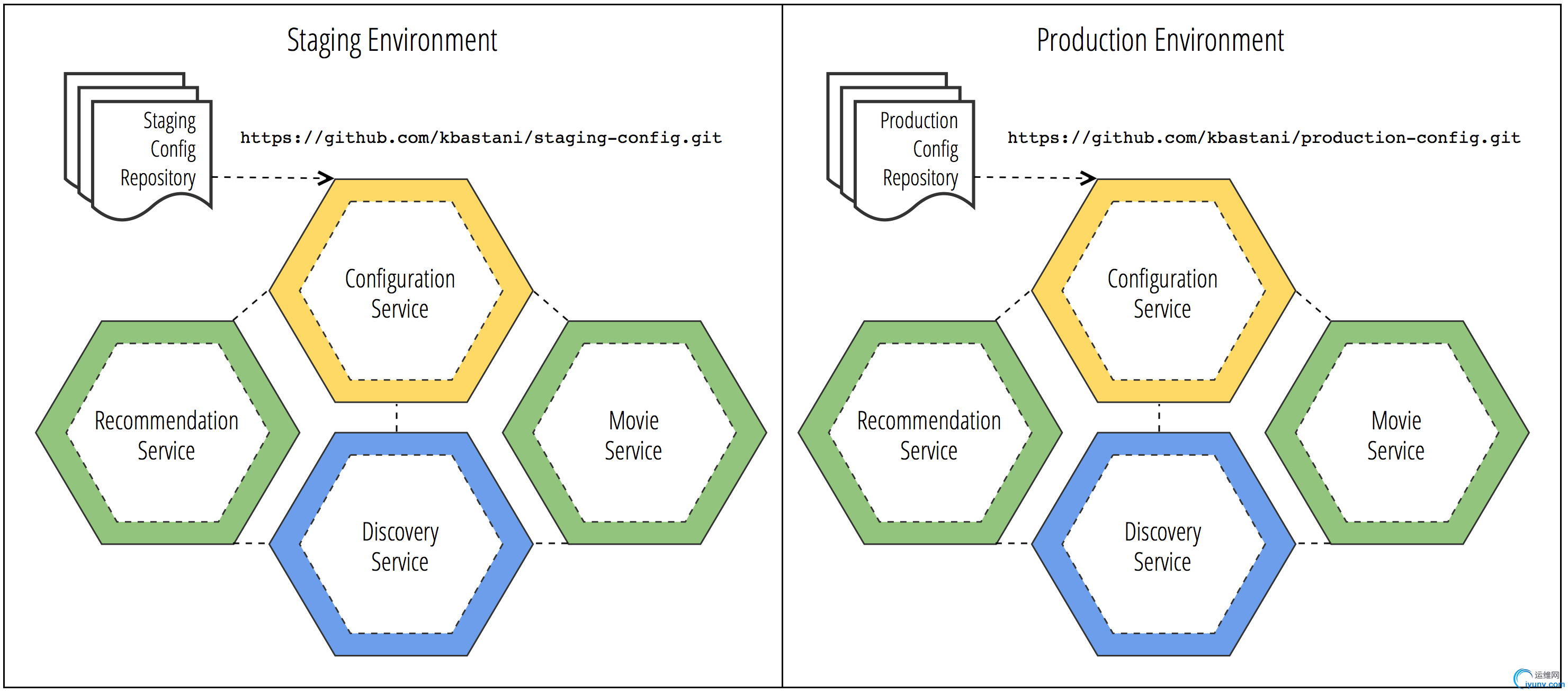

  Let's assume that we have multiple deployment environments. If we have a staging environment and a production environment, configurations for those environments will be different. A configuration service might have a dedicated Git repository for the configurations of that environment. None of the other environments will be able to access this configuration, it is available only to the configuration service running in that environment.
  假设我们有多个部署环境。一个测试环境,一个生产环境,他们的配置信息肯定是不一样的。配置服务(configuration service)会有一个独立的Git仓库,每个环境只会读取自己专属的配置信息。
  When the configuration service starts up, it will reference the path to those configuration files and begin to serve them up to the microservices that request those configurations. Each microservice can have their configuration file configured to the specifics of the environment that it is running in. In doing this, the configuration is both externalized and centralized in one place that can be version-controlled and revised without having to restart a service to change a configuration.
  当配置服务(configuration service)启动之后,他会根据路径为其他的微服务们提供读取配置文件的服务。每个微服务都拥有它正在运行的环境所使用的配置文件。实现了配置信息的外置化、集中化,并将它们置于版本控制下。这样一来,修改配置信息也就不用重启(配置)服务了。

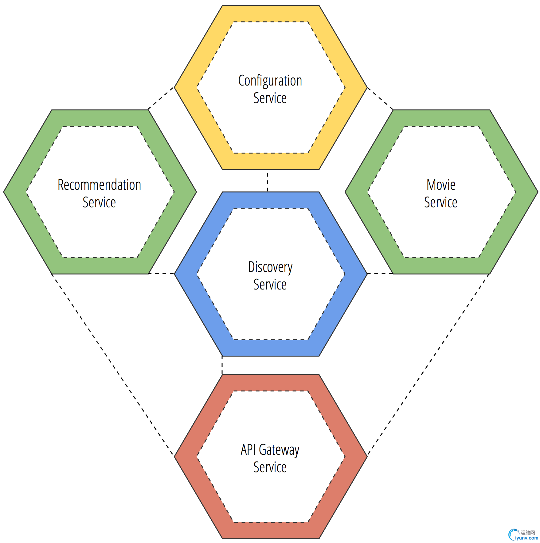

  API Gateway
  API 网关服务
  The API gateway service is another vital component if we are going to create a cluster of services managing their own domain entities. The green hexagons below are our data-driven services that manage their own domain entities and even their own databases. By adding an API gateway service, we can create a proxy of each API route that are exposed by the green services.
  如果我们想要创建一个服务集群来管理他们自己的域实体(注),那么,API网关服务(API Gateway)也是一个必不可少的组件。
  Let’s assume that both the recommendation service and the movie service expose their own REST API over the domain entities that they manage. The API gateway will discover these services through the discovery service and inject a proxy-based route of the API methods from the other services. In this way, both the recommendation and movie microservice will have a full definition of routes available locally from all the microservices that expose a REST API. The API Gateway will re-route the request to the service instances that own the route being requested through HTTP.
  让我们假设刚才介绍的两个服务和movie服务已经通过域实体暴露了REST API。API网关服务(API Gateway)会通过发现服务(discovery service)发现这些服务,并且将它们的接口函数,从其他服务那里注入基于代理的路由。这样,上面说的三个服务就具有了完整的REST API的路由(serviceID+apiUrl)。API网关服务(API Gateway)将接口调用重定向成HTTP请求到对应的服务实例上。

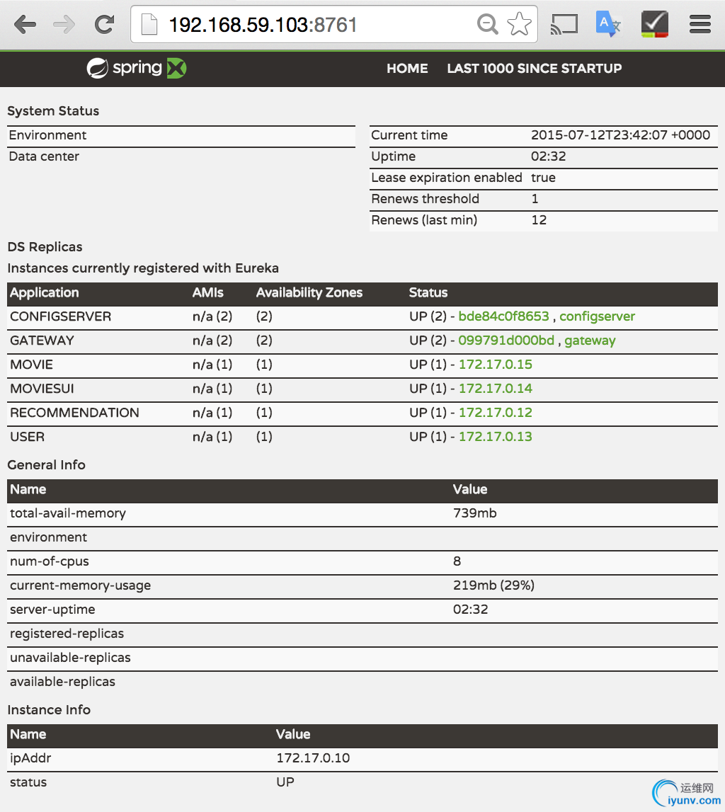

  Once the startup sequence iscompleted, you can navigate to the Eureka host and see which services haveregistered with the discovery service.
  Copy and paste the followingcommand into the terminal where Docker can be accessed using the $DOCKER_HOST environment variable.
  启动完毕之后,你可以登陆到Eureka服务器上,查看有哪些服务被发现服务注册在了上面。
  登陆Eureka的方法:在命令行终端运行下面的命令(保证可以通过环境变量 $DOCKER_HOST可以登陆Docker):

  If Eureka correctly started up, abrowser window will open to the location of the Eureka service’s dashboard, as shown below.
  如果Eureka被正常启动了,浏览器会打开Eureka的控制台,如下图所示。
  We can see each of the serviceinstances that are running and their status. We can then access one of the data-driven services, for example the movie service.
  我们可以在上看见所有已经启动的服务实例,以及他们的状态。怎样登陆一个以数据驱动的服务呢?以movie服务为例:
