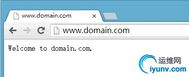

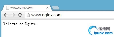

基于虚拟主机配置Nginx:
10
11
12
13
14
15
16
17
18
19
vim /etc/nginx/nginx.conf
        server {
                listen 172.16.4.33:80;
                server_name www.nginx.com;
                root /www;
        location /www {
                index index.html index.htm;
        server {
                server_name www.domain.com;
                root /qqq
        location /qqq {
准备主页文件:
    mkdir /www  /qqq
    echo "Welcome to nginx. >  /www/index.html
    echo "Welcome to domian. > /qqq/index.html
启动Nginx:
    /usr/local/nginx/sbin/nginx
       # 此时即定义了两个虚拟主机,关于配置文件含义在另一篇博客中有详解,此处就不在做介绍;

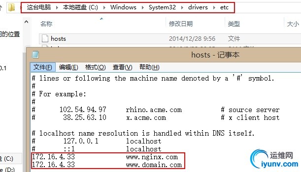

测试方法:
    做一台DNS服务器,建立一条两条A记录,分别指向这两台虚拟主机,或直接修改客户端的hosts文件,将这两个域名与IP的对应关系写在其中即可;
OK,两个虚拟主机都测试成功;

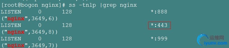

基于端口:
10
11
12
13
14
15
16
17
18
19
        server {
                listen 172.16.4.33:888;
                root /www;
        location /www {
        server {
                listen 172.16.4.33:999;
                root /qqq
        location /qqq {
    此时在用浏览器加上端口访问即可;
基于Openssl 服务实现 https:
    环境,CA及与Nginx在同一台机器上;
1、为CA生成自签证书:
    cd /etc/pki/CA
    (umask 077;openssl genrsa -out private/cakey.pem 2048)
10
11
12
13
14
15
16
17
18
[iyunv@bogon CA]# openssl req -new -x509 -key private/cakey.pem -days 3655 -out cacert.pem
You are about to be asked to enter information that will be incorporated
into your certificate request.
What you are about to enter is what is called a Distinguished Name or a DN.
There are quite a few fields but you can leave some blank
For some fields there will be a default value,
If you enter '.', the field will be left blank.
Country Name (2 letter code) [XX]:CN
State or Province Name (full name) []:HA
Locality Name (eg, city) [Default City]:ZZ
Organization Name (eg, company) [Default Company Ltd]:MageEdu
Organizational Unit Name (eg, section) []:tech
Common Name (eg, your name or your server's hostname) []:example.com
Email Address []:mail@example.com
[iyunv@bogon CA]# touch {index.txt,serial}
[iyunv@bogon CA]# echo 01 > serial
2、为Nginx生成私钥,并申请证书:
  cd /etc/nginx/
    (umask 077;openssl genrsa -out nginx.key 2048)
10
11
12
13
14
15
16
17
18
19
[iyunv@bogon nginx]# openssl req -new -key nginx.key -out nginx.csr -days 365
Common Name (eg, your name or your server's hostname) []:nginx.com
Email Address []:mail@nginx.com
Please enter the following 'extra' attributes
to be sent with your certificate request
A challenge password []:
An optional company name []:
3、签署证书:
  [iyunv@bogon nginx]# openssl ca -in nginx.csr -out nginx.crt -days 365
4、更改Nginx配置文件,支持https:(默认Nginx的SSL配置文件是注释的,启用起来即可)
10
11
12
13
14
15
16
server {
        listen       443 ssl;
        ssl_certificate      nginx.crt;
        ssl_certificate_key  nginx.key;
        ssl_session_cache    shared:SSL:1m;
        ssl_session_timeout  5m;
        ssl_ciphers  HIGH:!aNULL:!MD5;
        ssl_prefer_server_ciphers  on;
        location / {
            root   /www;
killall nginx

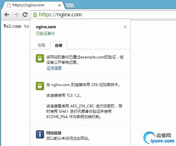

5、导出CA证书到客户机:
    将刚刚为CA自签的证书cacert.pem 倒出到客户机,并重命名为 cacert.crt,双击倒入到受信任的根证书颁发机构:
6、验证https工作是否正常:
OK,Nginx服务启用https功能,到此处即完成;
