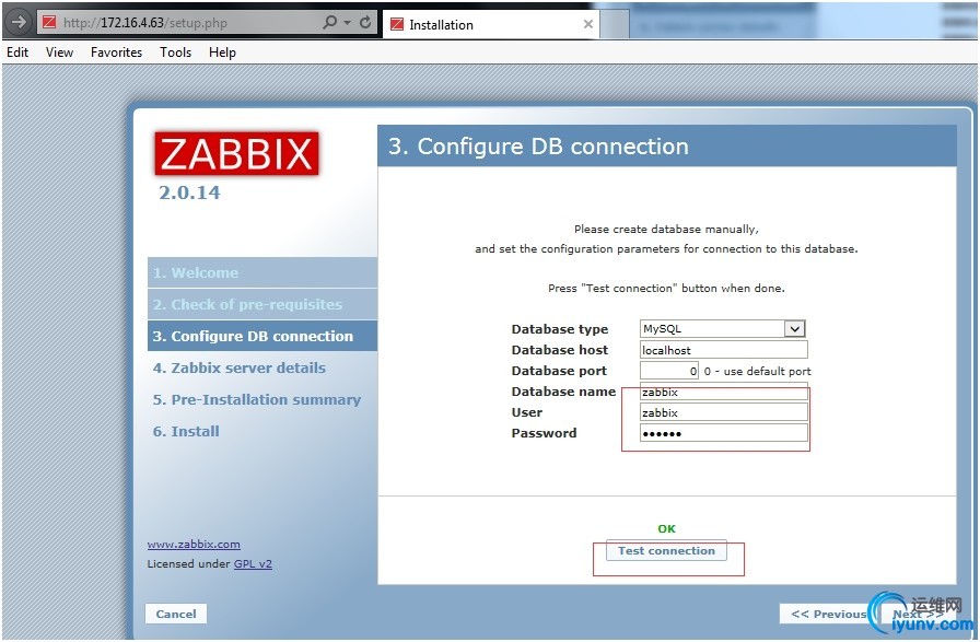

4.Server端数据库配置:初始化数据库-->创建zabbix数据库-->导入zabbix数据库
[iyunv@zabbix ~]# mysqladmin -u root password '123456'
[iyunv@zabbix ~]# mysql -u root p
mysql>create database zabbix character set utf8;
mysql> grant all on zabbix.* to zabbix@localhost identified by '123456';
mysql> use zabbix;
mysql> source /root/zabbix-2.2.6/database/mysql/schema.sql
mysql> source /root/zabbix-2.2.6/database/mysql/images.sql
mysql> source /root/zabbix-2.2.6/database/mysql/data.sql
mysql> exit

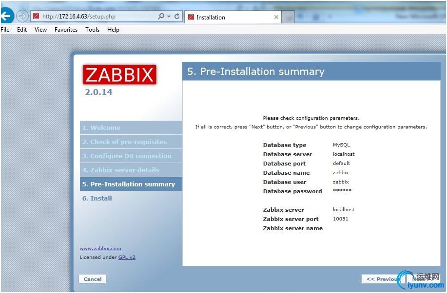

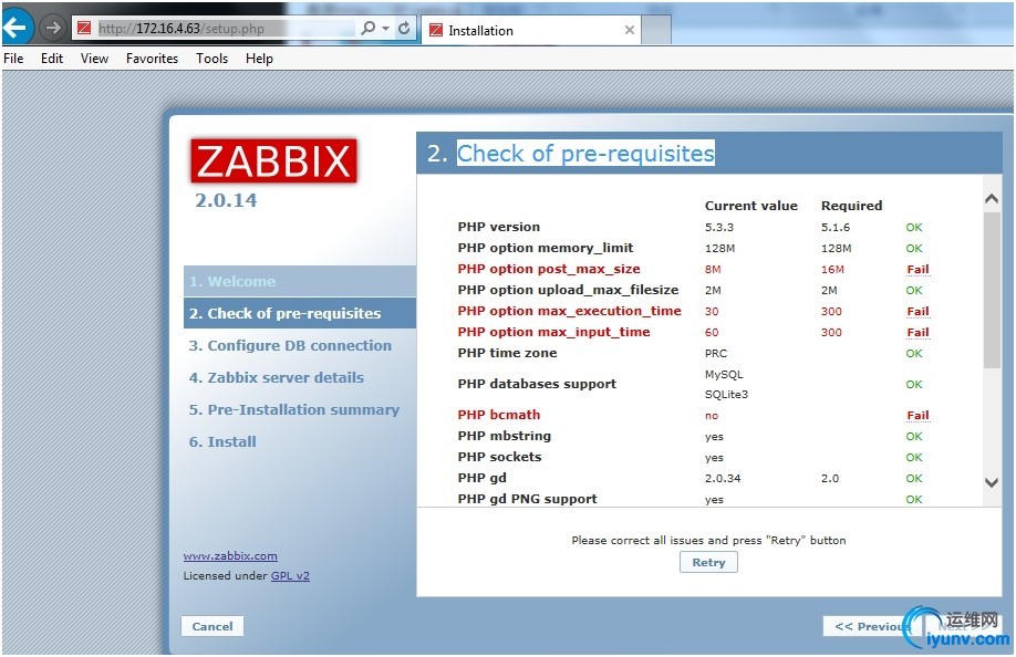

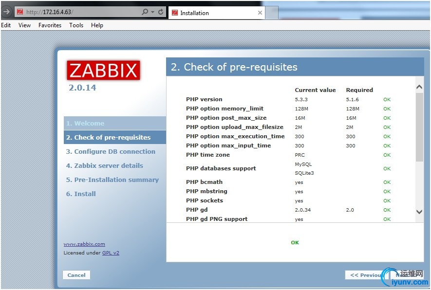

8.开始安装
打开浏览器输入http://172.16.4.62显示如下
红色字报错:按提示修改/etc/php.ini如下:
[iyunv@zabbix ~]# sed   -i '/post_max_size/s/8/16/g;/max_execution_time/s/30/300/g;/max_input_time/s/60/300/g;'  /etc/php.ini
<strong
[iyunv@zabbix ~]# yum install - y php-bcmath
[iyunv@zabbix ~]# /etc/init.d/httpd restart
Stopping httpd:                                            [  OK  ]
Starting httpd: httpd: apr_sockaddr_info_get() failed for zabbix
httpd: Could not reliably determine the server's fully qualified domain name, using 127.0.0.1 for ServerName   [OK]

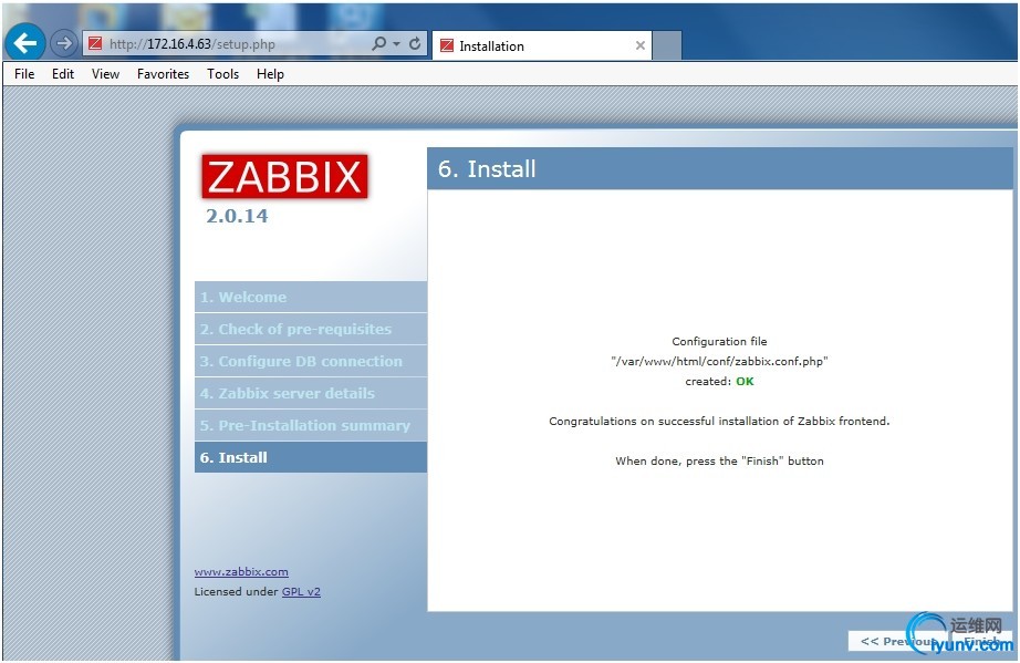

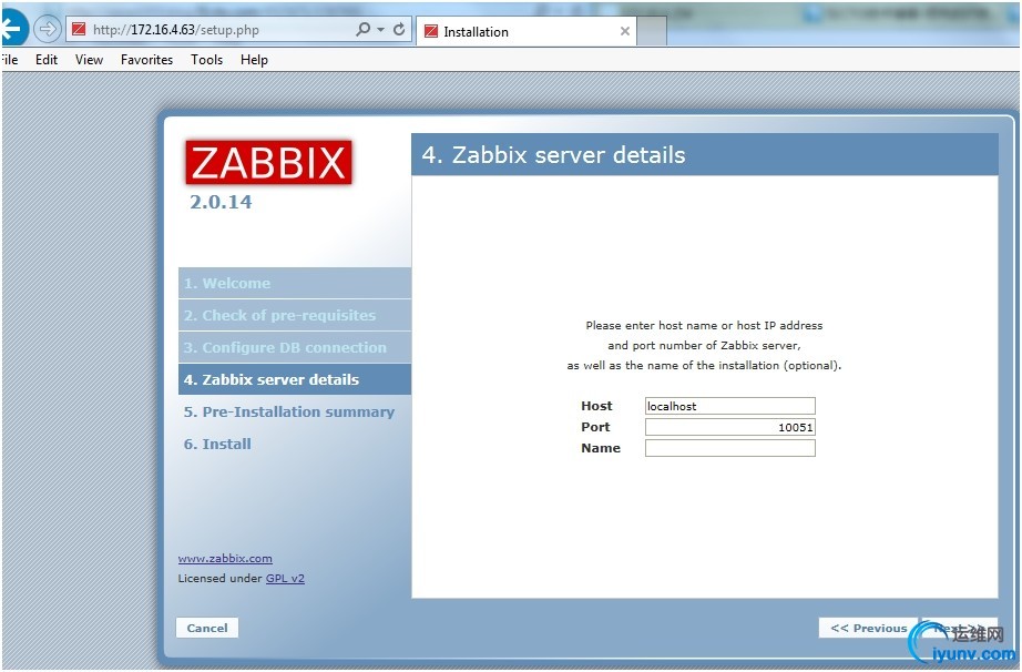

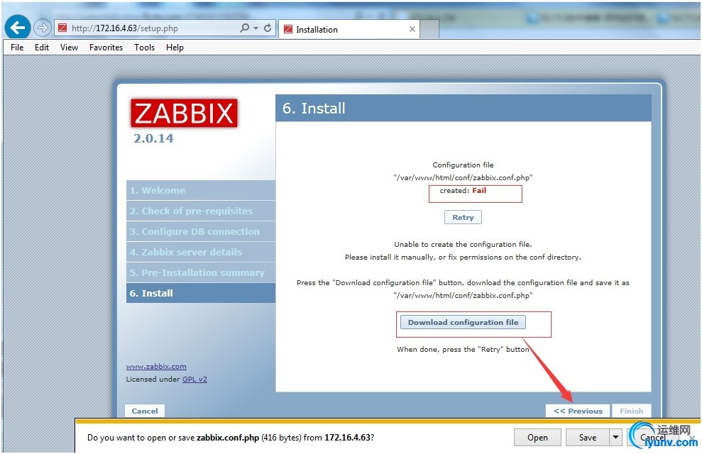

修改后的图:
wKiom1S957-ACH2wAAPiQ1mWXRs119.jpg wKioL1S96JTRWXgiAAO4GHQHL0k293.jpg wKioL1S96JTwHfWVAAQGHcgjm_g637.jpg wKiom1S958Hhf6d3AATylpEwWkM334.jpg
点击download configuration file下载上传到server端的/var/www/html/conf下即可。如下

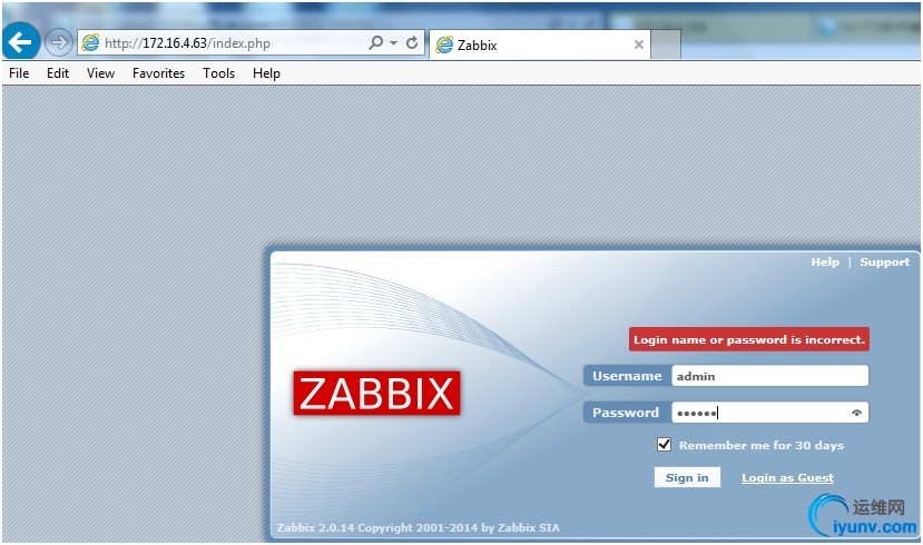

下面登陆:帐号:admin 密码:zabbix (默认)

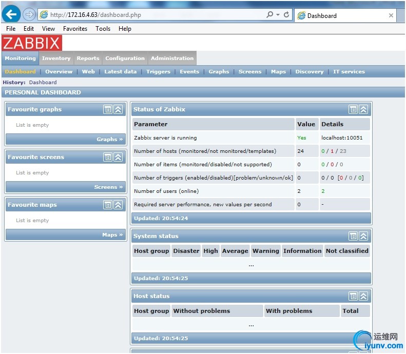

登陆后的界面:
到此安装结束
