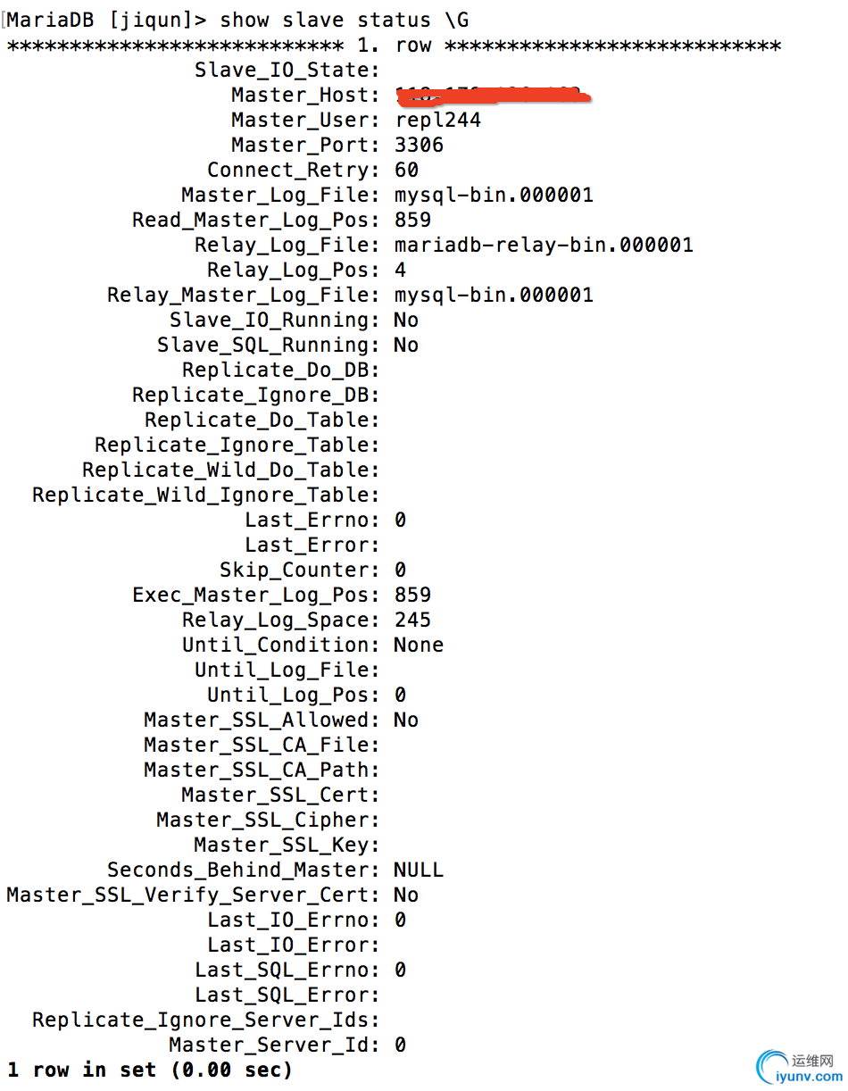

  4、通过show slave status \G查看监听状态
  错误:Last_IO_Error: error connecting to master 'repl163@118.xxx.xxx.1:3306' - retry-time: 60  retries: 2
  表示连接出错,检查得知为ip写错了;
  ERROR 1198 (HY000): This operation cannot be performed with a running slave; run STOP SLAVE first
  表示在没有解锁的情况下停止slave进程:需要clear slave;
  然后再执行change master to...
  5、show slave status \G没有问题后启动;
start slave
