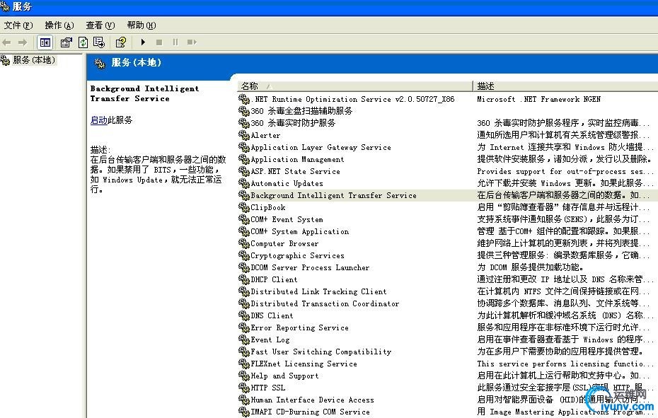

3、接着打开运行,输入services.msc出现如下界面:
然后找到下面服务,并确定这些服务已启动,否则设置他们为已启动。
DHCP  Client 设为已启动
DNS Client 设为已启动
Windows Firewall / Internet Connection Sharing(ICS) 设为已启动.

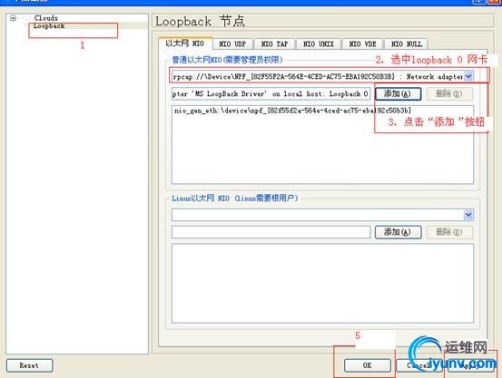

   配置Cloud “Loopback”,右键单击“Loopback”选择“配置“,按顺序进行以下操作即可:

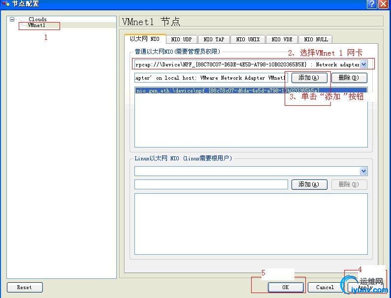

   配置Cloud “VMnet 1”,右键单击“VMnet 1”选择“配置“,按顺序进行以下操作即可:

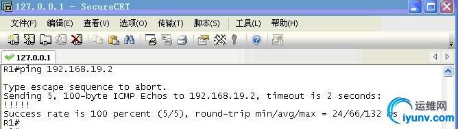

R1#ping 192.168.0.2
Type escape sequence to abort.
Sending 5, 100-byte ICMP Echos to 192.168.0.2, timeout is 2 seconds:
Success rate is 100 percent (5/5), round-trip min/avg/max = 1/3/4 ms
R1#ping 192.168.19.1
Sending 5, 100-byte ICMP Echos to 192.168.19.1, timeout is 2 seconds:
Success rate is 100 percent (5/5), round-trip min/avg/max = 1/1/4 ms

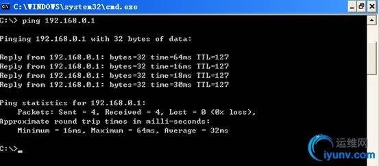

12、测试连通性:
1)测试虚拟机与路由器R1的联通性成功:

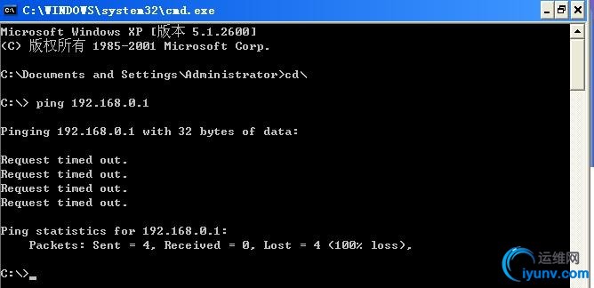

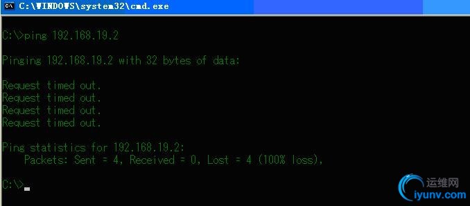

2)测试虚拟机与物理机Loopback 0网卡的连通性失败:

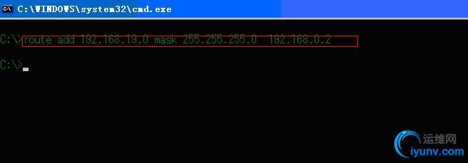

13解决虚拟机与物理机Loopback 0网卡无法联通:切换到物理机的桌面并打开“运行”输入cmd,进行route 命令操作:
A、查看物理机的路由表发现并无路由指向192.168.19.0网段:
   B、向物理机添加路由条目192.168.19.0:
    C、再测试虚拟机与Loopback 0网卡的连通性成功并且与外网沟通:
