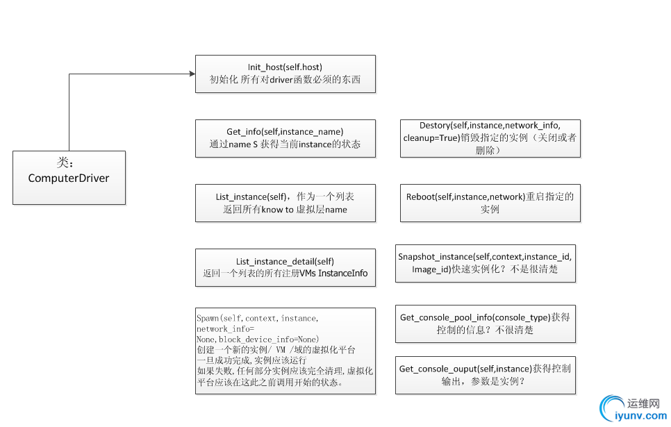

  这个文件位于\nova\virt,是一个底层的driver.py,源代码如下(和以前一样添加了些注释,另外把我 觉得比较重要的computerDriver类列出来 了,并将下面的每个函数分离 加以注释《见下面图片》!我看见后面好多函数都是继承的ComputerDriver比如nova\virt\libvirt下面的connection.py里面的class LibvirtConnection(driver.ComputeDriver):):

  •     #此处为了让大家看的明白 将 ComputerDriver的类图 列出来
  •     def init_host(self, host):
  •         """Initialize anything that is necessary for the driver to function,
  •         including catching up with currently running VM's on the given host."""
  •         # TODO(Vek): Need to pass context in for access to auth_token
  •         raise NotImplementedError()
  •     def get_info(self, instance_name):
  •         """Get the current status of an instance, by name (not ID!)
  •         Returns a dict containing:
  •         :state:           the running state, one of the power_state codes
  •         :max_mem:         (int) the maximum memory in KBytes allowed
  •         :mem:             (int) the memory in KBytes used by the domain
  •         :num_cpu:         (int) the number of virtual CPUs for the domain
  •         :cpu_time:        (int) the CPU time used in nanoseconds
  •     def list_instances(self):
  •         Return the names of all the instances known to the virtualization
  •         layer, as a list.
  •     def list_instances_detail(self):
  •         """Return a list of InstanceInfo for all registered VMs"""
  •     def spawn(self, context, instance,
  •               network_info=None, block_device_info=None):
  •         Create a new instance/VM/domain on the virtualization platform.
  •         Once this successfully completes, the instance should be
  •         running (power_state.RUNNING).
  •         If this fails, any partial instance should be completely
  •         cleaned up, and the virtualization platform should be in the state
  •         that it was before this call began.
  •         :param context: security context
  •         :param instance: Instance object as returned by DB layer.
  •                          This function should use the data there to guide
  •                          the creation of the new instance.
  •         :param network_info:
  •            :py:meth:`~nova.network.manager.NetworkManager.get_instance_nw_info`
  •         :param block_device_info:
  •     def destroy(self, instance, network_info, cleanup=True):
  •         """Destroy (shutdown and delete) the specified instance.
  •         If the instance is not found (for example if networking failed), this
  •         function should still succeed.  It's probably a good idea to log a
  •         warning in that case.
  •         :param cleanup:
  •     def reboot(self, instance, network_info):
  •         """Reboot the specified instance.
  •     def snapshot_instance(self, context, instance_id, image_id):
  •     def get_console_pool_info(self, console_type):
  •     def get_console_output(self, instance):
  •     def get_ajax_console(self, instance):
  •     def get_diagnostics(self, instance):
  •         """Return data about VM diagnostics"""
  •     def get_host_ip_addr(self):
  •         Retrieves the IP address of the dom0

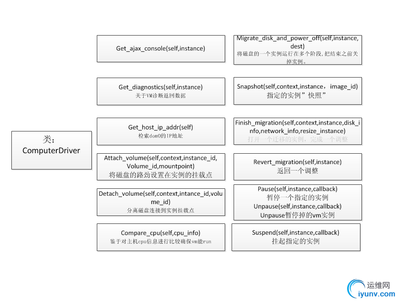

  •     def attach_volume(self, context, instance_id, volume_id, mountpoint):
  •         """Attach the disk at device_path to the instance at mountpoint"""
  •     def detach_volume(self, context, instance_id, volume_id):
  •         """Detach the disk attached to the instance at mountpoint"""
  •     def compare_cpu(self, cpu_info):
  •         """Compares given cpu info against host 确保vm能运行
  •         Before attempting to migrate a VM to this host,
  •         compare_cpu is called to ensure that the VM will
  •         actually run here.
  •         :param cpu_info: (str) JSON structure describing the source CPU.
  •         :returns: None if migration is acceptable
  •         :raises: :py:class:`~nova.exception.InvalidCPUInfo` if migration
  •                  is not acceptable.
  •     def migrate_disk_and_power_off(self, instance, dest):
  •         Transfers the disk of a running instance in multiple phases, turning
  •         off the instance before the end.
  •     def snapshot(self, context, instance, image_id):
  •         Snapshots the specified instance.
  •         :param image_id: Reference to a pre-created image that will
  •                          hold the snapshot.
  •     def finish_migration(self, context, instance, disk_info, network_info,
  •                          resize_instance):
  •         #打开一个迁移的实例,完成一个调整
  •         """Completes a resize, turning on the migrated instance
  •     def revert_migration(self, instance):
  •         #返回一个调整,推动回到实例?
  •         """Reverts a resize, powering back on the instance"""
  •     def pause(self, instance, callback):
  •         """Pause the specified instance."""
  •     def unpause(self, instance, callback):
  •         """Unpause paused VM instance"""
  •     def suspend(self, instance, callback):
  •         # 挂起指定的实例
  •         """suspend the specified instance"""
