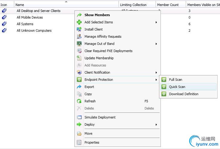

  •   Notify Endpoint Protection Agent to perform action as soon as possible.
      Among Endpoint Protection operations, Full Scan and Quick Scan are one-time operations, and therefore only depend on the client notification channel. Other operations will go through both the client notification channel as well as the traditional normal policy channel. From a client notification perspective, the validity period for a task is one hour. For example, if the clients are offline after task gets triggered, the initial push will fail. If the client gets online within one hour of the task push, then notification server will re-push the task to clients. If client gets online in more than 1 hour, the task will not be pushed as it will have expired.

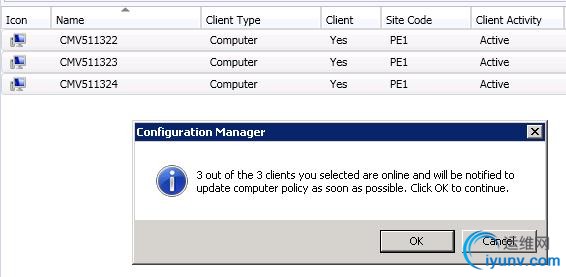

      DownloadComputer Policy is a newly added client operation in Configuration Manager SP1. It can notify the selected clients or collection to download computer policy as soon as possible outside the configured client policy polling interval. In the Configuration Manager console, click Assets and Compliance, in theAssets and Compliance workspace, click in the Collections group, select the device collection containing the computers that you want to download, in the Home tab, in the Collections group, click Client Notification and then click Download Computer Policy.  Whenyou perform this client operation on a collection, all online clients within the hierarchy belonging to this collection will be notified. You can also notify multiple computers specifically instead of the whole collection to download policy as soon as possible.
      There is also a confirmation dialog that pops up to inform you of the estimated number of online clients.
      The client will request policy from the management point as soon as possible as shown in the figure below:

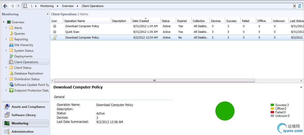

  •   Monitor Client Operation Status.
      You can monitor the client operation status in the Client Operations node in the Monitoring workspace. If the task is successfully delivered to clients, it will be counted in the Success column.

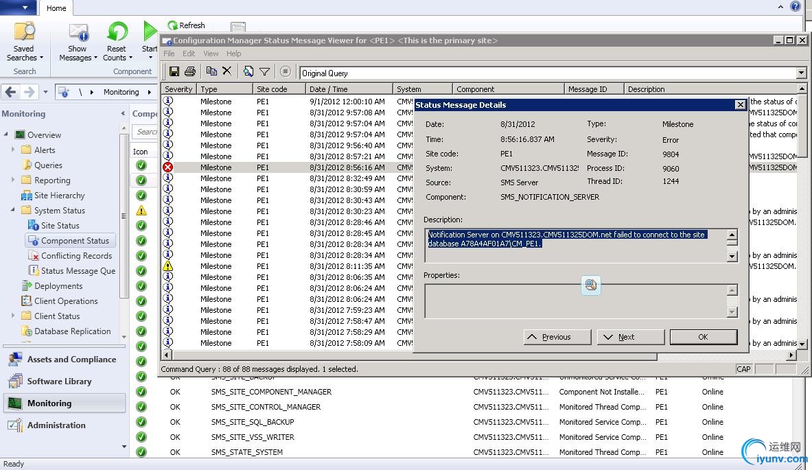

  •   Notification manager and notification server provide rich status messages that can help you monitor client notification tasks. In the Configuration Manager console, click Monitoring, expand System Status, click Component Status, select SMS_NOTIFICATION_SERVER or SMS_NOTIFICATION_MANAGER, and then click Show Messages to see status messages for this component.
