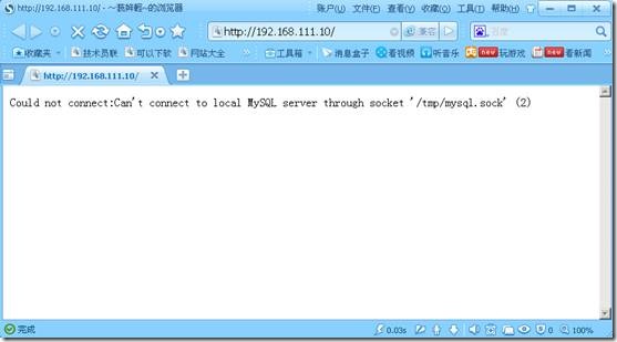

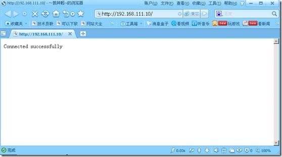

小编这里编写了一个很小的测试页面来测试啦
# vim /usr/local/nginx/html/index.php
<?php
$err=mysql_connect("localhost","root","123456")
or die("Could not connect:".mysql_error());
print("Connected successfully");
mysql_close($err);
再一次在客户机浏览器输入http://192.168.111.10试试
如果将mysqld服务停止再试试看
# service mysqld stop
