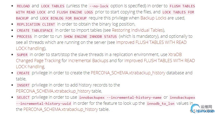

  1)连接服务器权限
  MariaDB [hellodb]> CREATE USER 'backuser'@'localhost'>
  MariaDB [hellodb]> GRANT>
  MariaDB [hellodb]>FLUSH PRIVILEGES;
  授权时特别注意 localhost 不能用 %
  官方文档中的权限描述:

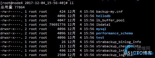

  innobackupex -ubackuser -psmile /backup
  备份后在/backup 文件夹下生成一个当前时间戳的文件夹
  xtrabackup_binlog_info  记录mysql服务器当前正在使用的二进制日志文件及至备份这一刻为止二进制日志事件的位置
  [root@node4 2017-12-04_15-56-40]# cat xtrabackup_binlog_info binlog.000010   1814    0-1-56MariaDB [hellodb]> SHOW MASTER STATUS;+---------------+----------+--------------+------------------+| File          | Position | Binlog_Do_DB | Binlog_Ignore_DB |+---------------+----------+--------------+------------------+| binlog.000010 |     1814 |              |                  |+---------------+----------+--------------+------------------+
  xtrabackup_checkpoints 记录备份类型,日志序列号(LSN),及备份状态
  [root@node4 2017-12-04_15-56-40]# cat xtrabackup_checkpoints backup_type = full-backuped(当--apply-log后  backup_type = full-prepared)from_lsn = 0to_lsn = 1899901last_lsn = 1899910compact = 0recover_binlog_info = 0
  ib_buffer_pool, buffer pool 中的热数据,当设置 innodb_buffer_pool_dump_at_shutdown=1 ,在关闭 MySQL 时,会把内存中的热数据保存在磁盘里 ib_buffer_pool 文件中,位于数据目录下。
  ibdata1,备份的共享表空间文件;
  xtrabackup_info,记录备份的基本信息,uuid、备份命令、备份时间、binlog、LSN、以及其他加密压缩等信息。
  [root@node4 2017-12-04_15-56-40]# cat xtrabackup_info uuid = abd4d399-d8c8-11e7-b084-000c293e4e76name = tool_name = innobackupextool_command = -ubackuser -psmile /backuptool_version = 2.4.8ibbackup_version = 2.4.8server_version = 10.2.10-MariaDB-logstart_time = 2017-12-04 15:56:40end_time = 2017-12-04 15:56:44lock_time = 0binlog_pos = filename 'binlog.000010', position '1814', GTID of the last change '0-1-56'innodb_from_lsn = 0innodb_to_lsn = 1899901partial = Nincremental = Nformat = filecompact = Ncompressed = Nencrypted = N
  xtrabackup_logfile,备份的重做日志文件。
  backup-my.cnf,备份命令用到的配置选项信息
