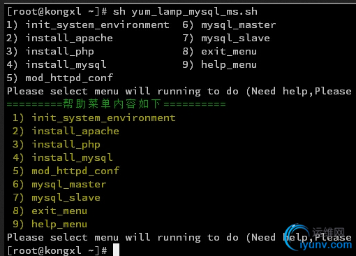

#!/bin/bash
#select menu yum install lamp and mysql master_slave
#by colink in 2015-04-28,05-13
#version v.c.m.0.3
BACKUP_DIR="/data/backup/`date +%Y%m%d`/"
IPADDR=`ifconfig eth0|grep Bcast |awk '{print $2}'|sed 's/addr://g'`

function init_system_environment(){
        echo -e "\033[32mNow,Will begin initialization system,Please wait...\033[0m"
        yum -y install cmake vim wget lrzsz unzip man ntpdate gcc* \
autoconf libtool python-devel libXpm-devel ncurses-devel git
        echo "alias vi='vim'" >>/root/.bashrc ; source /root/.bashrc ;
        chkconfig --level 3 iptables off ; chkconfig --level 3 ip6tables off
        ntpdate pool.ntp.org
        sed -i "/^SELINUX=enforcing/s/enforcing/disabled/g" /etc/selinux/config
        if [ $? -eq 0 ];then
                echo -e "\033[32mINIT ststem done. Will reboot system, Input Y|y or N|n :\033[0m"
                read -n 1 do_reboot
                case ${do_reboot} in
                        Y|y) init 6 ;;
                        N|n) break ;;
                esac
        fi

function mysql_master(){
        MYSQL_RUN_STATUS=`ps -ef |grep "mysql" |grep -Ev "grep|lamp" |wc -l`
        echo -e "\033[32m=============================================\033[0m"
        echo -e "\033[32mPlease waiting,ntpdate is working...\033[0m"
        sleep 1
    if [ "${MYSQL_RUN_STATUS}" -eq 0 ];then
        echo -e "\033[32mThe mysql didn't installed,Now running install_mysql ...\033[0m"
                install_mysql;
    fi
        if [ ! -d ${BACKUP_DIR} ];then
        mkdir -p ${BACKUP_DIR}
    fi
    cp ${MYSQL_CONF} ${BACKUP_DIR}my`date +%Y%m%d%k%M%S`.conf
        #导入my.cnf配置文件内容
        cat >${MYSQL_CONF} <<EOF
[mysqld]
datadir=/var/lib/mysql
socket=/var/lib/mysql/mysql.sock
user=mysql
symbolic-links=0
log-bin=mysql-bin
server-id=1
auto_increment_offset=1
auto_increment_increment=2
[mysqld_safe]
log-error=/var/log/mysqld.log
pid-file=/var/run/mysqld/mysqld.pid
replicate-do-db=all
EOF
        echo -e "\033[32mThe mysql master is starting,please wait...\033[0m"
        sleep 1
        rm -rf ${BINLOG_NODE}
        find /var/lib/mysql/ -name "*mysql-bin*" -exec rm -rf {} \;;
        /etc/init.d/mysqld restart
        if [ "${MYSQL_RUN_STATUS}" -gt 0 ];then
            echo -e "\033[32mThe mysql master was started successfully...\033[0m"
        else
                echo -e "\033[31mThe mysql master was started failed, Please check...\033[0m"
            exit;
        fi
        sleep 1
        mysqladmin -u${MYSQL_USER} password ${MYSQL_PASSWORD}
        mysql -u${MYSQL_USER} -p${MYSQL_PASSWORD} -e "delete from mysql.user where User='';"
        mysql -u${MYSQL_USER} -p${MYSQL_PASSWORD} -e "grant replication slave on *.* \
to '$SYNC_USER'@'%' identified by '$SYNC_PASSWORD';flush privileges;"
        #定义binlog日志变量
        BINLOGNAME=`mysql  -u${MYSQL_USER} -p${MYSQL_PASSWORD} -e "show master \
status \G" |grep File |awk '{print $2}'`
        BINLOGNODE=`mysql  -u${MYSQL_USER} -p${MYSQL_PASSWORD} -e "show master \
status \G" |grep Position |awk '{print $2}'`
        echo "BINLOGNAME=$BINLOGNAME" >> ${BINLOG_NODE}
        echo "BINLOGNODE=$BINLOGNODE" >> ${BINLOG_NODE}
        echo "MASTER_IP=`ifconfig eth0|grep Bcast |awk '{print $2}'|sed 's/addr://g'`" >> ${BINLOG_NODE}
        echo -e "\033[32m拷贝binlog相关信息到slave主机上,请按提示输入相应的内容。\033[0m"
        read -p "Please input mysql-slave IPADDR: " SLAVE_IP
        #判断输入的IP是否合法
        judge_ip ${SLAVE_IP};
        until [ $? -eq 0 ];do
                read -p "Error IPADDR, Please input mysql-slave IPADDR again: " SLAVE_IP
        done
        echo
        scp ${BINLOG_NODE} /root/$0 root@${SLAVE_IP}:/root/
            echo
            echo -e "\033[32m已成功拷贝到mysql-slave,IP:${SLAVE_IP}的/root/下\033[0m"
        fi

function mysql_slave(){
    sleep 1
        install_mysql;
    fi
    fi
    #导入my.cnf配置文件内容
[mysqld]
user=mysql
symbolic-links=0
#log-bin=mysql-bin
server-id=2
auto_increment_offset=2
[mysqld_safe]
replicate-do-db=all

#功能选择菜单
menu=(
        install_apache
        install_php
        install_mysql
        mod_httpd_conf
        mysql_master
        mysql_slave
        exit_menu
        help_menu
#因为习惯性的把help放在最后,所以这里用${#menu[@]}
PS3="Please select menu will running to do (Need help,Please input: ${#menu[@]} ): "
select i in ${menu[@]}
do
        case $i in
        ${menu[0]}) ${menu[0]} ;;
        ${menu[1]}) ${menu[1]} ;;
        ${menu[2]}) ${menu[2]} ;;
        ${menu[3]}) ${menu[3]} ;;
        ${menu[4]}) ${menu[4]} ;;
        ${menu[5]}) ${menu[5]} ;;
        ${menu[6]}) ${menu[6]} ;;
        ${menu[7]}) exit ;;
        ${menu[8]})
                echo -e "\033[32m=========帮助菜单内容如下==========\033[0m"
                for ((i=0;i<"${#menu[@]}";i++))
                do
                        echo -e "\033[33m `expr $i + 1`) ${menu} \033[0m"
                done
