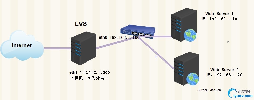

二、LVS-NAT模式演示
简单实验拓扑如下:

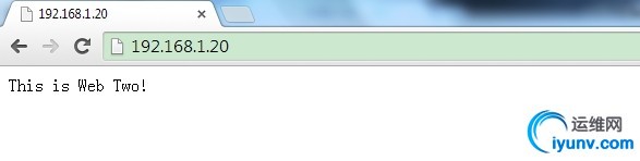

Web Server 1测试页
Web Server 2测试页

配置lvs-nat模型
10
11
[iyunv@lvs ~]# ipvsadm -A -t192.168.2.200:80 -s rr
[iyunv@lvs ~]# ipvsadm -a -t192.168.2.200:80 -r 192.168.1.10 -m -w 3
[iyunv@lvs ~]# ipvsadm -a -t192.168.2.200:80 -r 192.168.1.20 -m -w 1
[iyunv@lvs ~]# ipvsadm -Ln
IP Virtual Server version 1.2.1 (size=4096)
Prot LocalAddress:Port Scheduler Flags
-> RemoteAddress:Port          Forward Weight ActiveConn InActConn
TCP 192.168.2.200:80 rr
-> 192.168.1.20:80             Masq    1      0         0
-> 192.168.1.10:80             Masq    3      0         0
[iyunv@lvs ~]#

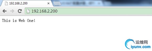

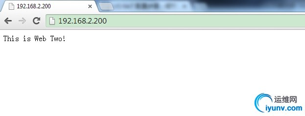

通过VIP访问
刷新(由于设置的权重一样,所以刷一下会变一下。)

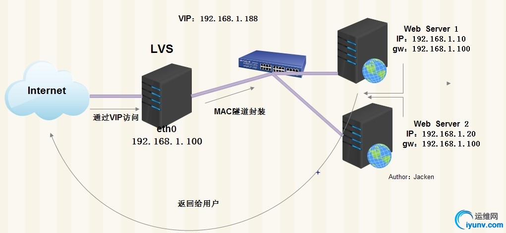

三、LVS-DR 模式演示
1、  IP规则
Director:
eth0 192.168.1.100 DIP
eth0:0 192.168.1.188 VIP
RS1:
eth0: 192.168.1.10 RIP
lo0:0 192.168.1.188 VIP
RS2:
eth0: 192.168.1.20 RIP

5、配置lvs-dr
10
11
[iyunv@lvs ~]# ipvsadm -A -t192.168.1.188:80 -s wlc
[iyunv@lvs ~]# ipvsadm -a -t192.168.1.188:80 -r 192.168.1.10 -g -w 2
[iyunv@lvs ~]# ipvsadm -a -t192.168.1.188:80 -r 192.168.1.20 -g -w 1
TCP 192.168.1.188:80 wlc
-> 192.168.1.20:80             Route   1      0         0
-> 192.168.1.10:80             Route   2      0         0
[iyunv@lvs ~]#

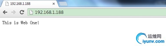

6、测试
刷新访问VIP 192.168.1.188
