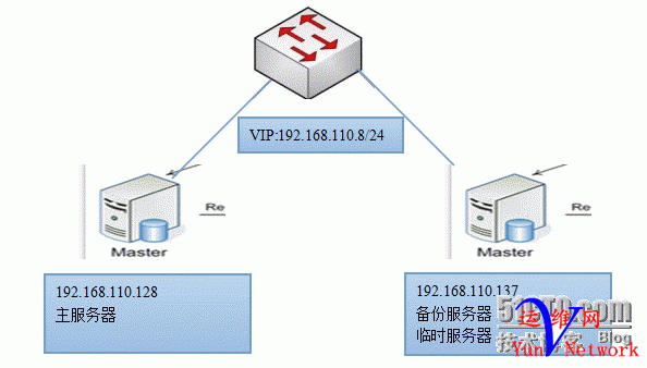

mysql master/slave结构最大的缺点:当master宕机时不能切换到slave,这样就影响了业务的运行。为了弥补这个缺陷,我采用了keepalived+master/master结构。如图:

在192.168.110.128上配置文件keepalived.conf
! Configuration File for keepalivedglobal_defs {   router_id MYSQL-HA}vrrp_instance keepalive_mysql {    state MASTER    interface eth0    virtual_router_id 51    priority 100    advert_int 1    preempt    authentication {        auth_type PASS        auth_pass 1111    }    virtual_ipaddress {        192.168.110.8/24    }}
在192.168.110.137上配置文件keepalived.conf
! Configuration File for keepalivedglobal_defs {    router_id MYSQL-HA}vrrp_instance keepalive_mysql {    state BACKUP    interface eth0    virtual_router_id 51    priority 99    advert_int 1    nopreempt    authentication {        auth_type PASS        auth_pass 1111    }    virtual_ipaddress {        192.168.110.8/24    }}
说明:
配置上注意priority的值,192.168.110.128是master,优先级要高。
preempt表示抢占服务,当192.168.110.128恢复后,重新把服务抢过来。
keepalived默认网卡eth0和自身服务出现问题时才会切换。
通过编写脚本来监控mysql的状态进而控制keeepalived服务
#!/bin/bashMYSQL="/usr/bin/mysql"MYSQL_HOST=127.0.0.1MYSQL_USER=adminMYSQL_PASSWORD=adminLOG_FILE="/opt/app/keepalived/check_mysql.log"MYSQL_OK=1 # mysql is working MYSQL_OK is 1 , mysql down MYSQL_OK is 0check_mysql_helth(){  $MYSQL -h$MYSQL_HOST -u$MYSQL_USER -p${MYSQL_PASSWORD} -e "show status" &>/dev/null  if [ $? = 0 ] ; then    MYSQL_OK=1  else    MYSQL_OK=0  fi                                                                                                                                                                                                                                                                                                return $MYSQL_OK}while :do  CHECK_TIME=3  while [ $CHECK_TIME -ne 0 ]  do    let "CHECK_TIME -= 1"    check_mysql_helth    [ $MYSQL_OK == 1 ] && break                                                                                                                                                                                                                                                                                                  if [ $MYSQL_OK -eq 0 ] && [ $CHECK_TIME -eq 0 ]; then      pkill keepalived      echo `date --date=today +"%Y-%M-%d %H:%m:%S"` - [INFO] - mysql invaild. keepalived stop. >> $LOG_FILE    fi  donedone
说明:
通过监控mysql服务状态来控制keepalived服务,这里mysql停掉则kill掉keepalived。
分别在两台机器上执行下面命令
shell>/opt/app/keepalived/sbin/keepalived -f  /opt/app/keepalived/etc/keepalived/keepalived.conf -Dshell>nohup sh /opt/app/keepalived/bin/check_mysql.sh &
把第二条命令写入/etc/rc.local。
测试:
> ip addr
>killall mysqld
查看192.168.110.137
此时192.168.110.137充当临时服务器。
恢复192.168.110.128上的业务后查看
此时业务被192.168.110.128抢占过来,192.168.110.137充当备份、临时服务器。
