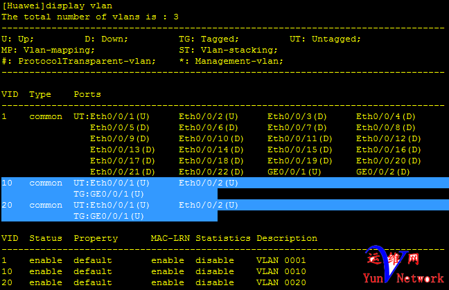

用display vlan查看配置是否正确
如图所示:

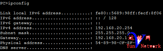

验证一下如果PC能自动获得IP地址且三台PC能够互通则前期工作完成
如图所示:
Ping 192.168.20.254: 32 data bytes, Press Ctrl_C to break
From 192.168.20.254: bytes=32 seq=1 ttl=127 time=94 ms
From 192.168.20.254: bytes=32 seq=2 ttl=127 time=47 ms
From 192.168.20.254: bytes=32 seq=3 ttl=127 time=78 ms
From 192.168.20.254: bytes=32 seq=4 ttl=127 time=62 ms
From 192.168.20.254: bytes=32 seq=5 ttl=127 time=63 ms
--- 192.168.20.254 ping statistics ---
5 packet(s) transmitted
5 packet(s) received
0.00% packet loss
round-trip min/avg/max = 47/68/94 ms
PC>ping 192.168.30.254
Ping 192.168.30.254: 32 data bytes, Press Ctrl_C to break
From 192.168.30.254: bytes=32 seq=1 ttl=127 time=78 ms
From 192.168.30.254: bytes=32 seq=2 ttl=127 time=47 ms
From 192.168.30.254: bytes=32 seq=3 ttl=127 time=78 ms
From 192.168.30.254: bytes=32 seq=4 ttl=127 time=78 ms
From 192.168.30.254: bytes=32 seq=5 ttl=127 time=94 ms
--- 192.168.30.254 ping statistics ---
0.00% packet loss
round-trip min/avg/max = 47/75/94 ms

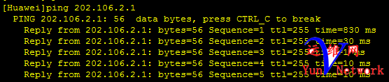

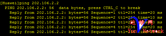

以上是配置IP地址,接下来是做静态路由
AR1
[Huawei]ip route-static 202.106.2.0 24 202.106.1.2
AR3
[Huawei]ip route-static 202.106.1.0 24 202.106.2.1
来验证一下三台路由器是否互通了
如图所示:

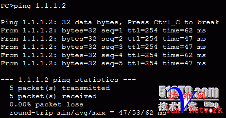

做到这一步要来个小检查,查看自己的PC能否Ping通三层交换机中所创建的VLAN的网关和AR1内网口的网关
如图所示:

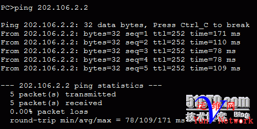

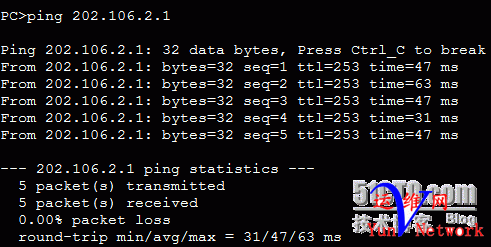

最后验证:
如图:
就此完成!
