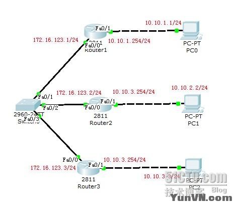

1.拓扑图

3.查看邻居表、拓扑表、路由表
  a.
r1#show ip ospf nei
Neighbor ID     Pri   State           Dead Time   Address         Interface
22.22.2.2         1   FULL/BDR        00:00:35    172.16.123.2    FastEthernet0/0
33.33.3.3         1   FULL/DROTHER    00:00:31    172.16.123.3    FastEthernet0/0
r1#show ip ospf nei
22.22.2.2         1   FULL/BDR        00:00:30    172.16.123.2    FastEthernet0/0
33.33.3.3         1   FULL/DROTHER    00:00:36    172.16.123.3    FastEthernet0/0
r1#show ip route
Codes: C - connected, S - static, I - IGRP, R - RIP, M - mobile, B - BGP
       D - EIGRP, EX - EIGRP external, O - OSPF, IA - OSPF inter area
       N1 - OSPF NSSA external type 1, N2 - OSPF NSSA external type 2
       E1 - OSPF external type 1, E2 - OSPF external type 2, E - EGP
       i - IS-IS, L1 - IS-IS level-1, L2 - IS-IS level-2, ia - IS-IS inter area
       * - candidate default, U - per-user static route, o - ODR
       P - periodic downloaded static route
Gateway of last resort is not set
     10.0.0.0/24 is subnetted, 3 subnets
C       10.10.1.0 is directly connected, FastEthernet0/1
O       10.10.2.0 [110/2] via 172.16.123.2, 00:06:07, FastEthernet0/0
O       10.10.3.0 [110/2] via 172.16.123.3, 00:05:57, FastEthernet0/0
     11.0.0.0/24 is subnetted, 1 subnets
C       11.11.1.0 is directly connected, Loopback0
     172.16.0.0/24 is subnetted, 1 subnets
C       172.16.123.0 is directly connected, FastEthernet0/0
r1#
b.
r2#show ip ospf nei
11.11.1.1         1   FULL/DR         00:00:38    172.16.123.1    FastEthernet0/0
r2#show ip ospf data
            OSPF Router with ID (22.22.2.2) (Process ID 100)
                Router Link States (Area 0)
Link ID         ADV Router      Age         Seq#       Checksum Link count
172.16.123.1    172.16.123.1    2475        0x80000003 0x0055f2 2
172.16.123.2    172.16.123.2    1926        0x80000005 0x006ed2 2
172.16.123.3    172.16.123.3    1651        0x80000007 0x0087b2 2
22.22.2.2       22.22.2.2       489         0x80000007 0x0063f0 2
11.11.1.1       11.11.1.1       489         0x80000007 0x003254 2
33.33.3.3       33.33.3.3       469         0x80000003 0x009c89 2
                Net Link States (Area 0)
172.16.123.1    11.11.1.1       469         0x80000004 0x00fd41
r2#show ip route
O       10.10.1.0 [110/2] via 172.16.123.1, 00:07:57, FastEthernet0/0
C       10.10.2.0 is directly connected, FastEthernet0/1
O       10.10.3.0 [110/2] via 172.16.123.3, 00:07:47, FastEthernet0/0
     22.0.0.0/24 is subnetted, 1 subnets
C       22.22.2.0 is directly connected, Loopback0
r2#
c.
r3#show ip ospf nei
22.22.2.2         1   FULL/BDR        00:00:33    172.16.123.2    FastEthernet0/0
11.11.1.1         1   FULL/DR         00:00:37    172.16.123.1    FastEthernet0/0
r3#show ip ospf data
            OSPF Router with ID (33.33.3.3) (Process ID 100)
172.16.123.1    172.16.123.1    2546        0x80000003 0x0055f2 2
172.16.123.2    172.16.123.2    1997        0x80000005 0x006ed2 2
172.16.123.3    172.16.123.3    1722        0x80000007 0x0087b2 2
22.22.2.2       22.22.2.2       560         0x80000007 0x0063f0 2
11.11.1.1       11.11.1.1       560         0x80000007 0x003254 2
33.33.3.3       33.33.3.3       540         0x80000003 0x009c89 2
172.16.123.1    11.11.1.1       540         0x80000004 0x00fd41
r3#show ip route
O       10.10.1.0 [110/2] via 172.16.123.1, 00:08:59, FastEthernet0/0
O       10.10.2.0 [110/2] via 172.16.123.2, 00:08:59, FastEthernet0/0
C       10.10.3.0 is directly connected, FastEthernet0/1
     33.0.0.0/24 is subnetted, 1 subnets
C       33.33.3.0 is directly connected, Loopback0
r3#
