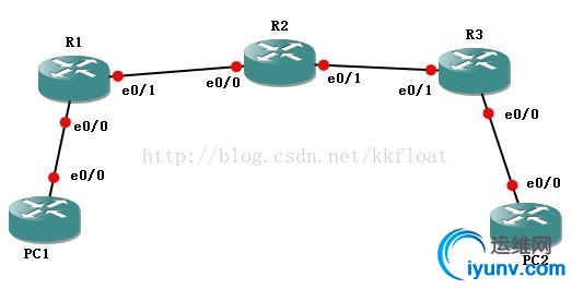

实验一、IPv4到IPv6过渡技术之双协议栈
PC1配置:
PC1#conf t
PC1(config)#no ip routing
PC1(config)#ip default-gateway 192.168.1.1
PC1(config)#ipv6 route ::/0 2014::1
PC1(config)#int e0/0
PC1(config-if)#ip add 192.168.1.2 255.255.255.0
PC1(config-if)#ipv6 add 2014::2/96
PC1(config-if)#no sh
PC1(config-if)#exit
R1配置:
R1#conf t
R1(config)#ipv6 unicast-routing
R1(config)#int e0/0
R1(config-if)#ip add 192.168.1.1 255.255.255.0
R1(config-if)#ipv6 add 2014::1/96
R1(config-if)#no sh
R1(config-if)#exit
R1(config)#int e0/1
R1(config-if)#ip add 192.168.12.1255.255.255.0
R1(config-if)#ipv6 add 2012::1/96
R1(config-if)#no sh
R1(config-if)#exit
R1(config)#ip route 192.168.2.0 255.255.255.0192.168.12.2
R1(config)#ipv6 route 2023::0/96 2012::2
R2配置:
R2#conf t
R2(config)#ipv6 unicast-routing
R2(config)#int e0/1
R2(config-if)#ip add 192.168.12.2255.255.255.0
R2(config-if)#ipv6 add 2012::2/96
R2(config-if)#no sh
R2(config-if)#exit
R2(config)#int e0/0
R2(config-if)#ip add 192.168.2.1 255.255.255.0
R2(config-if)#ipv6 add 2023::1/96
R2(config-if)#no sh
R2(config-if)#exit
R2(config)#ip route 192.168.1.0 255.255.255.0192.168.12.1
R2(config)#ipv6 route 2014::0/96 2012::1
PC2配置
PC2#conf t
PC2(config)#no ip routing
PC2(config)#ip default-gateway 192.168.2.1
PC2(config)#ipv6 route::/0 2023::1
PC2(config)#int e0/0
PC2(config-if)#ip add 192.168.2.2255.255.255.0
PC2(config-if)#ipv6 add 2023::2/96
PC2(config-if)#no sh
PC2(config-if)#exit
测试连通情况:
PC1#ping 2023::2
Type escape sequence to abort.
Sending 5, 100-byte ICMP Echos to 2023::2,timeout is 2 seconds:
Success rate is 100 percent (5/5), round-tripmin/avg/max = 56/68/104 ms
PC1#ping 192.168.2.2
Sending 5, 100-byte ICMP Echos to 192.168.2.2,timeout is 2 seconds:
R1#debug ipv6 icmp
R1#ping 2023::2
*Mar  1 01:16:17.067: ICMPv6: Sending echo requestto 2023::2
*Mar  1 01:16:17.139: ICMPv6: Received echo replyfrom 2023::2
*Mar  1 01:16:17.139: ICMPv6: Sending echo requestto 2023::2
*Mar  1 01:16:17.175: ICMPv6: Received echo replyfrom 2023::2
*Mar  1 01:16:17.175: ICMPv6: Sending echo requestto 2023::2
*Mar  1 01:16:17.215: ICMPv6: Received echo replyfrom 2023::2
*Mar  1 01:16:17.215: ICMPv6: Sending echo requestto 2023::2
*Mar  1 01:16:17.255: ICMPv6: Received echo replyfrom 2023::2
*Mar  1 01:16:17.255: ICMPv6: Sending echo requestto 2023::2
*Mar  1 01:16:17.295: ICMPv6: Received echo replyfrom 2023::2

实验二、IPv4到IPv6过渡技术之6to4隧道
PC1配置:
PC1#conf t
PC1(config)#no iprouting
PC1(config-if)#ipv6add 2002::2/16
PC1(config-if)#exit
PC1(config)#ipv6route ::/0 2002::1
R1配置:
R1#conf t
R1(config)#ipv6unicast-routing
R1(config)#int e0/0
R1(config-if)#ipv6add 2002::1/16
R1(config-if)#no sh
R1(config-if)#exit
R1(config)#int e0/1
R1(config-if)#ip add192.168.12.1 255.255.255.0
R1(config-if)#no sh
R1(config-if)#exit
R1(config)#interfacetunnel 0
R1(config-if)#ipv6add 2014:1::1/96
R1(config-if)#tunnelsource 192.168.12.1
R1(config-if)#tunneldestination 192.168.23.3
R1(config-if)#tunnelmode ipv6ip
R1(config-if)#exit
R1(config)#ipv6route 2023::/16 2014:1::2
R1(config)#ip route0.0.0.0 0.0.0.0 e0/1
R2配置:
R2#conf t
R2(config)#int e0/0
R2(config-if)#ip add192.168.12.2 255.255.255.0
R2(config-if)#no sh
R2(config-if)#exit
R2(config)#int e0/1
R2(config-if)#ip add192.168.23.2 255.255.255.0
R2(config-if)#no sh
R2(config-if)#exit
R3配置:
R3#conf t
R3(config)#ipv6unicast-routing
R3(config)#int e0/0
R3(config-if)#ipv6add 2023::1/16
R3(config-if)#no sh
R3(config-if)#exit
R3(config)#int e0/1
R3(config-if)#ip add192.168.23.3 255.255.255.0
R3(config-if)#no sh
R3(config-if)#exit
R3(config)#inttunnel 0
R3(config-if)#ipv6add 2014:1::2/96
R3(config-if)#tunnelsource 192.168.23.3
R3(config-if)#tunneldestination 192.168.12.1
R3(config-if)#tunnelmode ipv6ip
R3(config-if)#exit
R3(config)#ip route0.0.0.0 0.0.0.0 e0/1
R3(config)#ipv6route 2002::/16 2014:1::1
PC2配置:
PC2#conf t
PC2(config)#no iprouting
PC2(config)#ipv6route ::/0 2023::1
PC2(config-if)#ipv6add 2023::2/16
PC2(config-if)#exit
测试联通:
PC1#traceroute2023::2
Type escape sequenceto abort.
Tracing the route to2023::2
  1 2002::1 72 msec 16 msec 20 msec
  2 2014:1::2 112 msec 100 msec 60 msec
  3 2023::2 112 msec 80 msec 68 msec
PC1#ping 2023::2
Sending 5, 100-byteICMP Echos to 2023::2, timeout is 2 seconds:
Success rate is 100percent (5/5), round-trip min/avg/max = 68/96/188 ms
R1#debug tunnel
Tunnel Interface debugging is on
*Mar  100:33:19.579: Tunnel0: IPv6/IP encapsulated 192.168.12.1->192.168.23.3(linktype=79, len=120)
*Mar  100:33:19.583: Tunnel0 count tx, adding 20 encap bytes
*Mar  100:33:19.699: Tunnel0: IPv6/IP to classify 192.168.23.3->192.168.12.1(tbl=0,"default" len=120 ttl=253 tos=0x0)
*Mar  100:33:19.703: Tunnel0: IPv6/IP (PS) to decaps 192.168.23.3->192.168.12.1(tbl=0, "default", len=120,ttl=253)
*Mar  100:33:19.703: Tunnel0: decapsulated IPv6/IP packet (len 120)

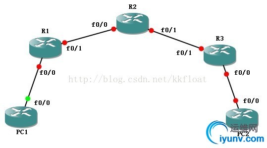

实验三、IPv4到IPv6过渡技术之ISATAP(站间自动隧道寻址协议)
PC1配置:
PC1#conf t
PC1(config)#ipdefault-gateway 192.168.0.1
PC1(config-if)#ip add192.168.0.2 255.255.255.0
PC1(config-if)#exit
PC1(config)#int tunnel 0
PC1(config-if)#ipv6 addressautoconfig //ipv6地址设置成自动配置
PC1(config-if)#tunnel modeipv6ip //设置隧道模式为ipv6ip
PC1(config-if)#tunnel sourcee0/0 //隧道的源端口
PC1(config-if)#tunnel destination192.168.12.2//指定ISATAP路由器地址,ISATAP路由器就会分配给计算机一个路由器前缀,所有配置了ISATAP隧道的计算机都会分配到一个IPv6网段,也就是和ISATAP路由器的Tunnel 0接口在同一个网段。
R1配置:
R1#conf t
R1(config)#int e0/0
R1(config-if)#ip add192.168.0.1 255.255.255.0
R1(config-if)#no sh
R1(config-if)#exit
R1(config)#int e0/1
R1(config-if)#no sh
R1(config-if)#exit
R1(config)#ip route 0.0.0.00.0.0.0 192.168.12.2
R2配置:
R2#conf t
R2(config)#ipv6unicast-routing
R2(config)#int e0/0
R2(config-if)#no sh
R2(config-if)#exit
R2(config)#int e0/1
R2(config-if)#ipv6 add2323::1/64
R2(config-if)#no sh
R2(config-if)#exit
R2(config)#ip route192.168.0.0 255.255.255.0 192.168.12.1
R2(config)#ipv6 route2002::/96 2323::2
R2(config)#int tunnel 0
R2(config-if)#ipv6 add2001:3::/64 eui-64//注意IPv6的必须使用eui-64方式指定
R2(config-if)#no ipv6 ndsuppress-ra//在 IPv6 的接口上将不会发送路由器公告报文
R2(config-if)#tunnel source192.168.12.2//隧道源为e0/0接口IP,
R2(config-if)#tunnel modeipv6ip isatap//隧道模式为ISATAPServer
R2(config-if)#exit
R3配置:
R3#conf t
R3(config)#int e0/0
R3(config-if)#ipv6 add2002::1/96
R3(config-if)#no sh
R3(config-if)#exit
R3(config)#int e0/1
R3(config-if)#ipv6 add2323::2/64
R3(config-if)#no sh
R3(config-if)#exit
R3(config)#ipv6 route ::/02323::1
PC2配置:
PC2#conf t
PC2(config)#ipv6 route ::/02002::1
PC2(config-if)#ipv6 add2002::2/96
PC2(config-if)#exit
测试网络:
PC1#sh ipv6 interface brief
Ethernet0/0                [up/up]
Tunnel0                    [up/up]
    FE80::C0A8:2
2001:3::C0A8:2
PC1#ping 2002::2 //PC1去ping PC2
Type escape sequence toabort.
Sending 5, 100-byte ICMPEchos to 2002::2, timeout is 2 seconds:
Success rate is 100 percent(5/5), round-trip min/avg/max = 60/95/172 ms
PC2#ping 2001:3::C0A8:2 //PC2去ping PC1
Sending 5, 100-byte ICMPEchos to 2001:3::C0A8:2, timeout is 2 seconds:
Success rate is 100 percent(5/5), round-trip min/avg/max = 60/86/180 ms
R2#debug tunnel
Tunnel Interface debugging ison
*Mar  1 01:11:11.823: Tunnel0: IPv6/IP to classify192.168.0.2->192.168.12.2 (tbl=0,"default" len=120 ttl=253tos=0x0)
*Mar  1 01:11:11.831: Tunnel0: IPv6/IP (PS) todecaps 192.168.0.2->192.168.12.2 (tbl=0, "default",len=120,ttl=253)
*Mar  1 01:11:11.831: Tunnel0: decapsulated IPv6/IPpacket (len 120)
*Mar  1 01:11:11.903: Tunnel0 count tx, adding 20encap bytes

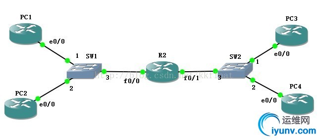

实验四、IPv4到IPv6过渡技术之NAT-PT
   NAT-PT(网络地址转换-协议转换)是一种地址转换技术,它可以把IPv6地址转换成IPv4地址,反之亦然。NAT-PT基于RFC2766中定义的无状态IP/ICMP转换器(SIIT)算法。SIIT算法互译IPv4和IPv6数据包头部,也包括ICMP头部。需要注意的是,在IPv6环境中,不建议像IPv4对待NAT的态度哪样,去使用NAT。仅仅在V4单协议与V6单协议网络需要互相通信的时候,才建议使用NAT-PT。
PC1配置:
PC1#conf t
PC1(config)#noip routing
PC1(config)#inte0/0
PC1(config-if)#ipv6add 2012::11/16
PC1(config-if)#nosh
PC1(config-if)#exit
PC1(config)#ipv6route ::/0 2012::1
PC2配置:
PC2#conf t
PC2(config)#noip routing
PC2(config)#inte0/0
PC2(config-if)#ipv6add 2012::22/16
PC2(config-if)#nosh
PC2(config-if)#exit
PC2(config)#ipv6route  ::/0 2012::1
PC3配置:
PC3#conf t
PC3(config)#noip routing
PC3(config)#ipdefault-gateway 192.168.34.1
PC3(config)#inte0/0
PC3(config-if)#ipadd 192.168.34.3 255.255.255.0
PC3(config-if)#nosh
PC3(config-if)#exit
PC4配置:
PC4#conf t
PC4(config)#noip routing
PC4(config)#ipdefault-gateway 192.168.34.1
PC4(config)#inte0/0
PC4(config-if)#ipadd 192.168.34.4 255.255.255.0
PC4(config-if)#nosh
PC4(config-if)#exit
R1基本配置:
R2#conf t
R2(config)#intfa0/0
R2(config-if)#ipv6add 2012::1/16
R2(config-if)#nosh
R2(config-if)#exit
R2(config)#intfa0/1
R2(config-if)#ipadd 192.168.34.1 255.255.255.0
R2(config-if)#nosh
R2(config-if)#exit
方法一使用静态双向NAT-PT使网络联通,如下配置R1,然后测试PC1与PC3
R2#conf t
R2(config)# ipv6 natprefix 2034:34:34::/96 //抓取IPv4转换成IPv6后的前缀,不能与现有网络相同
R2(config)# ipv6 nat v4v6source 192.168.34.3 2034:34:34::3//将ipv4映射到ipv6
R2(config)# ipv6 natv4v6 source 192.168.34.4 2034:34:34::4//将ipv4映射到ipv6
R2(config)#ipv6nat v6v4 source 2012::11 192.168.34.11//将ipv6映射到ipv4
R2(config)#ipv6nat v6v4 source 2012::22 192.168.34.22//将ipv6映射到ipv4
R2(config)#intfa0/0
R2(config-if)#ipv6nat
R2(config-if)#exit
R2(config)#intfa0/1
R2(config-if)#exit
PC1#ping2034:34:34::3  repeat 1
Typeescape sequence to abort.
Sending 5,100-byte ICMP Echos to 2034:34:34::3, timeout is 2 seconds:
Successrate is 100 percent (5/5), round-trip min/avg/max = 48/89/152 ms
PC3#ping192.168.34.11 repeat 1
Sending 5,100-byte ICMP Echos to 192.168.34.11, timeout is 2 seconds:
Successrate is 100 percent (5/5), round-trip min/avg/max = 20/52/144 ms
R2#debugipv6 nat
*Mar  1 00:40:25.519: IPv6 NAT: icmp src (2012::11)-> (192.168.34.11), dst (2034:34:34::3) -> (192.168.34.3)
*Mar  1 00:40:25.527: IPv6 NAT: icmp src(192.168.34.3) -> (2034:34:34::3), dst (192.168.34.11) -> (2012::11)
*Mar  1 00:42:37.235: IPv6 NAT: icmp src(192.168.34.3) -> (2034:34:34::3), dst (192.168.34.11) -> (2012::11)
*Mar  1 00:42:37.287: IPv6 NAT: icmp src (2012::11)-> (192.168.34.11), dst (2034:34:34::3) -> (192.168.34.3)
方法二动态NAT-PT(V4地址池),配置R1,然后测试PC1与PC3联通
R2#conf t
R2(config)#ipv6access-list ipv6-network permit 2012::/16 any //定义允许被IPv6 nat的源地址
R2(config)#ipv6 nat v6v4 pool ip6v4-pool 192.168.34.100 192.168.34.200 prefix-length 24 //定义需要将IPv6转换成IPv4的地址池
R2(config)#ipv6nat v6v4 source list ipv6-network pool ip6v4-pool //设置IPv6转换成IPv4
R2(config)#ipv6nat prefix 2034:34:34::/96 //抓取IPv4转换成IPv6后的前缀,不能与现有网络相同
R2(config)# ipv6 natv4v6 source 192.168.34.3 2034:34:34::3//将ipv4映射到ipv6
R2(config)#intfa0/0
R2(config-if)#exit
R2(config)#intfa0/1
R2(config-if)#exit
PC1#ping2034:34:34::3 repeat 1//必须先从动态转换的一方去ping静态转换的一方
Sending 1,100-byte ICMP Echos to 2034:34:34::3, timeout is 2 seconds:!
Successrate is 100 percent (1/1), round-trip min/avg/max = 112/112/112 ms
PC3#ping192.168.34.100 repeat 1//再从静态转换一方去ping另一方动态转换后的地址
Sending 1,100-byte ICMP Echos to 192.168.34.100, timeout is 2 seconds:!
Successrate is 100 percent (1/1), round-trip min/avg/max = 120/120/120 ms
R2#debugipv6 nat
IPv6NAT-PT debugging is on
*Mar  1 02:20:41.519: IPv6 NAT: icmp src (2012::11)-> (192.168.34.100), dst (2034:34:34::3) -> (192.168.34.3)
*Mar  1 02:20:41.591: IPv6 NAT: icmp src(192.168.34.3) -> (2034:34:34::3), dst (192.168.34.100) -> (2012::11)
*Mar  1 02:20:47.087: IPv6 NAT: icmp src(192.168.34.3) -> (2034:34:34::3), dst (192.168.34.100) -> (2012::11)
*Mar  1 02:20:47.135: IPv6 NAT: icmp src (2012::11)-> (192.168.34.100), dst (2034:34:34::3) -> (192.168.34.3)
方法三动态NAT-PT(V6地址池),配置R1,然后测试PC1与PC3联通
R2#conf t
R2(config)#access-list1 permit 192.168.34.0 0.0.0.255 //匹配要转换的网络
R2(config)#ipv6nat v4v6 pool ip4v6-pool 2034:34:34::3 2034:34:34::4 prefix-length 96 //创建一个IPv6的地址池
R2(config)#ipv6nat v4v6 source list 1 pool ip4v6-pool //将IPv4转换成IPv6地址池的任意地址
R2(config)#ipv6nat v6v4 source 2012::11 192.168.34.11//将IPv6静态映射为IPv4
R2(config)#ipv6nat v6v4 source 2012::22 192.168.34.22//将IPv6静态映射为IPv4
R2(config)#intfa0/0
R2(config-if)#exit
R2(config)#intfa0/1
R2(config-if)#exit
PC3#ping192.168.34.11 repeat 1 //必须先从动态转换的一方去ping静态转换的一方
Sending 1,100-byte ICMP Echos to 192.168.34.11, timeout is 2 seconds:!
Successrate is 100 percent (1/1), round-trip min/avg/max = 104/104/104 ms
PC1#ping2034:34:34::3 repeat 1//再从静态转换一方去ping另一方动态转换后的地址
Successrate is 100 percent (1/1), round-trip min/avg/max = 132/132/132 ms
R2#debugipv6 nat
*Mar  1 03:05:08.043: IPv6 NAT: icmp src (2012::11)-> (192.168.34.11), dst (2034:34:34::3) -> (192.168.34.3)
*Mar  1 03:05:08.119: IPv6 NAT: icmp src(192.168.34.3) -> (2034:34:34::3), dst (192.168.34.11) -> (2012::11)
*Mar  1 03:05:14.891: IPv6 NAT: icmp src (192.168.34.3)-> (2034:34:34::3), dst (192.168.34.11) -> (2012::11)
*Mar  1 03:05:14.947: IPv6 NAT: icmp src (2012::11)-> (192.168.34.11), dst (2034:34:34::3) -> (192.168.34.3)
方法四动态NAT-PT之v4-Mapped,配置R1,然后测试PC1与PC3联通
R2(config)#ipv6nat v6v4 pool v6v4-pool 192.168.34.11 192.168.34.22 prefix-length 24
R2(config)#ipv6nat v6v4 source list ipv6only-network pool v6v4-pool
R2(config)#ipv6access-list IPv4over6 permit 2012:1::/16 2034:34:34::/96
R2(config)#ipv6nat prefix 2034:34:34::/96 v4-mapped IPv4over6
R2(config)#intfa0/0
R2(config-if)#exit
R2(config)#intfa0/1
R2(config-if)#exit
然后将192.168.34.3和192.168.34.4换算成IPv6地址,即分别为
fe80:0:0:0:0:0:c0a8:2203和fe80:0:0:0:0:0:c0a8:2204
接着再把前缀换成2034:34:34::/96,最后变成
2034:34:34::c0a8:2203/96 和2034:34:34::c0a8:2204/96
PC1#ping2034:34:34::c0a8:2204 repeat 1 //必须先从IPv6一方ping通IPv4

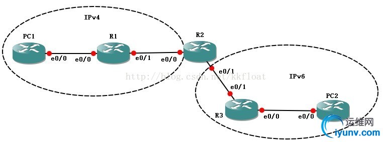

Sending 1,100-byte ICMP Echos to 2034:34:34::C0A8:2204, timeout is 2 seconds:!
PC3#ping192.168.34.4 repeat 1//再从IPv4一方ping通IPv6从地址池转换后的地址
Sending 1,100-byte ICMP Echos to 192.168.34.4, timeout is 2 seconds:!
Successrate is 100 percent (1/1), round-trip min/avg/max = 44/44/44 ms
R2#debugipv6 nat
*Mar  1 03:49:47.115: IPv6 NAT: icmp src (2012::11)-> (192.168.34.11), dst (2034:34:34::C0A8:2204) -> (192.168.34.4)
*Mar  1 03:49:47.191: IPv6 NAT: icmp src(192.168.34.4) -> (2034:34:34::C0A8:2204), dst (192.168.34.11) ->(2012::11)
v4-mapped整个流程是:先用一条IPv6的ACL来匹配需要进行v4-mapped的流量,注意这条ACL的目的地就是NAT-PT的IPv6前缀,然后使用ipv6 nat prefix 2034:34:34::/96 v4-mapped IPv4over6命令关联这条ACL。这样一来当PC1访问PC4时,可以直接使用2034:34:34::c0a8:2204这个地址,后面的c0a8:2204是将要被翻译成IPv4的地址,也就是PC4的192.168.34.4。因此R1收到这个IPv6数据包的时候,发现数据包匹配上了v4map这个ACL,因此将目的IPv6地址的最后32bits翻译成IPv4格式(这就是IPv4目的地址),然后从V4地址池中取出一个地址替换掉IPv6地址。这样做的目的是减少IPv4的手动配置映射
实验五、IPv6静态路由及默认路由
PC1配置:
PC1#conf t
PC1(config)#noip routing //关闭路由功能,作PC
PC1(config)#ipv6route ::/0 2001::1 //设置IPv6的网关
PC1(config)#inte0/0
PC1(config-if)#ipv6add 2001::2/16 //设置端口的IPv6地址
PC1(config-if)#nosh//启动端口
PC1(config-if)#exit
R1配置:
R1#conf t
R1(config)#ipv6unicast-routing//开启IPv6路由功能支持
R1(config)#inte0/0
R1(config-if)#ipv6add 2001::1/16
R1(config-if)#nosh
R1(config-if)#exit
R1(config)#inte0/1
R1(config-if)#ipv6add 1212:1212:1212::1/64
R1(config-if)#nosh
R1(config-if)#exit
R1(config)# ipv6 route::/0 1212:1212:1212::2 //设置IPv6默认路由
R2配置:
R2#conf t
R2(config)#ipv6unicast-routing //开启IPv6路由功能支持
R2(config)#inte0/0
R2(config-if)#ipv6add 1212:1212:1212::2/64
R2(config-if)#nosh
R2(config-if)#exit
R2(config)#inte0/1
R2(config-if)#ipv6add 2323:2323:2323::2/96
R2(config-if)#nosh
R2(config-if)#exit
R2(config)#ipv6route 2001::/16 1212:1212:1212::1//IPv6静态路由去往2001::/16
R2(config)#ipv6route 2002::/16 2323:2323:2323::3//IPv6静态路由去往2002::/16
R3配置:
R3#conf t
R3(config)#inte0/1
R3(config-if)#ipv6add 2323:2323:2323::3/96
R3(config-if)#nosh
R3(config-if)#exit
R3(config)#inte0/0
R3(config-if)#ipv6  add 2002::1/16
R3(config-if)#nosh
R3(config-if)#exit
R3(config)#ipv6route ::/0 2323:2323:2323::2
PC2配置:
PC2#conf t
PC2(config)#inte0/0
PC2(config-if)#ipv6add 2002::2/16
PC2(config-if)#nosh
PC2(config-if)#exit
PC2(config)#ipv6route ::/0 2002::1
测试网络联通:
PC1#traceroute2002::2
Tracingthe route to 2002::2
  1 2001::1 68 msec 20 msec 20 msec
  2 1212:1212:1212::2 60 msec 52 msec 40 msec
  3 2323:2323:2323::3 72 msec 60 msec 60 msec
  4 2002::2 128 msec 72 msec 68 msec
PC2#traceroute2001::2
Tracingthe route to 2001::2
  1 2002::1 12 msec 60 msec 20 msec
  2 2323:2323:2323::2 60 msec 40 msec 40 msec
  3 1212:1212:1212::1 76 msec 60 msec 60 msec
  4 2001::2 108 msec 80 msec 80 msec
实验六、IPv6动态路由之RIPng
PC1配置:
PC1#conf t
PC1(config)#inte0/0
PC1(config-if)#nosh
PC1(config-if)#exit
R1配置:
R1#conf t
R1(config)#ipv6unicast-routing //开启IPv6路由支持功能
R1(config)#ipv6router rip 1//开启IPv6 RIP协议,进程名称为1
R1(config-rtr)#split-horizon//设置IPv6 RIP 进程使用水平分割
R1(config-rtr)#poison-reverse//设置IPv6 RIP 进程使用毒性逆转
R1(config-rtr)#exit
R1(config)#inte0/0
R1(config-if)#ipv6rip 1 enable //将接口宣告进RIP进程1中
R1(config-if)#nosh
R1(config-if)#exit
R1(config)#inte0/1
R1(config-if)#ipv6add 1212:1212:1212::1/48
R1(config-if)#nosh
R1(config-if)#exit
R2配置:
R2#conf t
R2(config)#ipv6route ::/0 null0 //添加一条空接口的默认路由,用于宣告进RIP
R2(config)#inte0/0
R2(config-if)#exit
R2(config)#ipv6router rip 1
R2(config-rtr)#split-horizon
R2(config-rtr)#poison-reverse
R2(config-rtr)#exit
R2(config)#inte0/0
R2(config-if)#ipv6add 1212:1212:1212::2/48
R2(config-if)#ipv6rip 1 default-information originate //将默认路由通过RIP从这个接口宣告出去
R2(config-if)#ipv6rip 1 enable
R2(config-if)#nosh
R2(config-if)#exit
R2(config)#inte0/1
R2(config-if)#ipv6add 2323:2323:2323:2323::2/64
R2(config-if)#nosh
R2(config-if)#exit
R3配置:
R3#conf t
R3(config)#ipv6router rip 1
R3(config-rtr)#split-horizon
R3(config-rtr)#poison-reverse
R3(config-rtr)#exit
R3(config)#inte0/1
R3(config-if)#ipv6add 2323:2323:2323:2323::3/64
R3(config-if)#ipv6rip 1 enable
R3(config-if)#nosh
R3(config-if)#exit
R3(config)#inte0/0
R3(config-if)#ipv6add 2002::1/16
R3(config-if)#nosh
R3(config-if)#exit
PC2配置:
PC2#conf t
PC2(config)#inte0/0
PC2(config-if)#nosh
PC2(config-if)#exit
配置完成,测试联通,查看路由表:
PC2#ping2001::2
Sending 5,100-byte ICMP Echos to 2001::2, timeout is 2 seconds:
Successrate is 100 percent (5/5), round-trip min/avg/max = 68/111/248 ms
R3#sh ipv6route
IPv6Routing Table - 9 entries
Codes: C -Connected, L - Local, S - Static, R - RIP, B - BGP
       U - Per-user Static route
       I1 - ISIS L1, I2 - ISIS L2, IA - ISISinterarea, IS - ISIS summary
       O - OSPF intra, OI - OSPF inter, OE1 -OSPF ext 1, OE2 - OSPF ext 2
       ON1 - OSPF NSSA ext 1, ON2 - OSPF NSSAext 2
R   ::/0 [120/2]
     via FE80::CE01:BFF:FE1C:1, Ethernet0/1
R  1212:1212:1212::/48 [120/2]
R   2001::/16 [120/3]
C   2002::/16 [0/0]
     via ::, Ethernet0/0
L   2002::1/128 [0/0]
     via ::, Ethernet0/0
C   2323:2323:2323:2323::/64 [0/0]
     via ::, Ethernet0/1
L   2323:2323:2323:2323::3/128 [0/0]
     via ::, Ethernet0/1
L   FE80::/10 [0/0]
     via ::, Null0
L   FF00::/8 [0/0]
     via ::, Null0
R3#sh ipv6rip database
RIPprocess "1", local RIB
1212:1212:1212::/48, metric 2, installed
     Ethernet0/1/FE80::CE01:BFF:FE1C:1, expiresin 158 secs
2001::/16, metric 3, installed
2323:2323:2323:2323::/64, metric 2
::/0, metric 2, installed
R3#debugipv6 rip
RIPRouting Protocol debugging is on
*Mar  1 00:28:36.675: RIPng: response received fromFE80::CE01:BFF:FE1C:1 on Ethernet0/1 for 1
*Mar  1 00:28:36.675:        src=FE80::CE01:BFF:FE1C:1 (Ethernet0/1)
*Mar  1 00:28:36.679:        dst=FF02::9
*Mar  1 00:28:36.679:        sport=521, dport=521, length=112
*Mar  1 00:28:36.679:        command=2, version=1, mbz=0, #rte=5
*Mar  1 00:28:36.679:        tag=0, metric=1,prefix=1212:1212:1212::/48
*Mar  1 00:28:36.679:        tag=0, metric=1,prefix=2323:2323:2323:2323::/64
*Mar  1 00:28:36.683:        tag=0, metric=2, prefix=2001::/16
*Mar  1 00:28:36.683:        tag=0, metric=16, prefix=2002::/16
*Mar  1 00:28:36.683:        tag=0, metric=1, prefix=::/0
*Mar  1 00:28:35.283: RIPng: Sending multicast update on Ethernet0/0 for 1
*Mar  1 00:28:35.283:        src=FE80::CE02:BFF:FE1C:0
*Mar  1 00:28:35.283:        dst=FF02::9 (Ethernet0/0)
*Mar  1 00:28:35.287:        sport=521, dport=521, length=112
*Mar  1 00:28:35.287:        command=2, version=1, mbz=0, #rte=5
*Mar  1 00:28:35.287:        tag=0, metric=1,prefix=2323:2323:2323:2323::/64
*Mar  1 00:28:35.287:        tag=0, metric=1, prefix=2002::/16
*Mar  1 00:28:35.287:        tag=0, metric=2,prefix=1212:1212:1212::/48
*Mar  1 00:28:35.287:        tag=0, metric=3, prefix=2001::/16
*Mar  1 00:28:35.291:        tag=0, metric=2, prefix=::/0
*Mar  1 00:28:35.291: RIPng: Sending multicast updateon Ethernet0/1 for 1
*Mar  1 00:28:35.291:        src=FE80::CE02:BFF:FE1C:1
*Mar  1 00:28:35.291:        dst=FF02::9 (Ethernet0/1)
*Mar  1 00:28:35.295:        sport=521, dport=521, length=112
*Mar  1 00:28:35.295:        command=2, version=1, mbz=0, #rte=5
*Mar  1 00:28:35.295:        tag=0, metric=1,prefix=2323:2323:2323:2323::/64
*Mar  1 00:28:35.295:        tag=0, metric=1, prefix=2002::/16
*Mar  1 00:28:35.295:        tag=0, metric=16,prefix=1212:1212:1212::/48
*Mar  1 00:28:35.299:        tag=0, metric=16, prefix=2001::/16
*Mar  1 00:28:35.299:        tag=0, metric=16, prefix=::/0
IPv6的RIPng协议是基于RIPv2协议的,但它并不是RrPv2的简单扩展,它实际上是一个完全独立的协议。RIPng协议不支持IPv4, 如果同时在IPv4和IPv6环境里使用RIP作为路由选择协议,就必须运行支持IPv4的RIPvl或RIPv2,以及支持IPv6的RIPng。RIPng使用与RlPv2相同的计时器、过程处理和消息类型。例如,RIPng像RIPv2—样,使用30s的更新计时器抖动来避免消息同步,还有180的超时周期、120s的垃圾收集计时器和180s的抑制计时器(默认显示0)。它也使用相同的跳数度量,16跳表示不可到达。RIPng也用与RIPv2相同的方式使用请求和响应消息(command1和command2)。另外,除了类似于RIPvl和RIPv2一样用到少数单播方式外,像RIPv2一样,RIPng大多是以多播方式收发请求和响应消息。RIPng使用的IPv6多播地址是FF02::9。除了上述这些类似的功能外,一个例外之处是认证功能。RIPng本身并没有认证机制,但是承担认证功能的特性已经集成到IPv6中了。当然,Rpng也不需要像RIPv2那样要求具有对R1Pvl的兼容性开关,因为它本来就不向后支持IPv4协议,RIPng采用UDP521端口(可修改),不再支持自动汇总,因为IPv6已经没有了A、B、C的主类分类,支持接口下的手工汇总
实验七、IPv6动态路由协议之EIGRP
IPv6 的EIGRP在本质上和IPv4没有区别,依旧采用DUAL算法,采用组播更新,触发更新。IPv6 的EIGRP直接配置在接口上,这样使得接口可以没有IPv6全局单播地址, IPv6的EIGRP没有网络状态. EIGRP在 IPv6上需要配置一个路由器ID(默认情况下会选择一个环回口作为RID,推荐手动设备EIGRPRID)。默认情况下eigrp进程是关闭的,需要在进程下用no shutdown 开启
PC1配置:
PC1#conf t
PC1(config)#intfa0/0
PC1(config-if)#nosh
PC1(config-if)#exit
R1配置:
R1#conf t
R1(config)#ipv6unicast-routing //开启IPv6路由功能
R1(config)#intfa0/0
R1(config-if)#ipv6eigrp 1 //设置IPv6的eigrp进程
R2(config-rtr)#router-id1.1.1.1//设置eigrp路由器ID
R1(config-if)#nosh//启动eigrp进程
R1(config-if)#exit
R1(config)#intfa0/1
R1(config-if)#ipv6eigrp 1 //将接口宣告到eigrp进程中
R1(config-if)#nosh
R1(config-if)#exit
R1(config)#ipv6router eigrp 1
R1(config-rtr)#nosh
R1(config-rtr)#exit
R2配置:
R2#conf t
R2(config)#ipv6 un
R2(config)#ipv6 router eigrp 1
R2(config-rtr)#router-id 2.2.2.2
R2(config-rtr)#no sh
R2(config-rtr)#exit
R2(config)#int fa0/0
R2(config-if)#ipv6 add1212:1212:1212::2/48
R2(config-if)#ipv6 eigrp 1
R2(config-if)#no sh
R2(config-if)#exit
R2(config)#int fa0/1
R2(config-if)#ipv6 add2323:2323:2323:2323::3/64
R2(config-if)#no sh
R2(config-if)#exit
R3配置:
R3#conf t
R3(config)#ipv6 un
R3(config)#ipv6 unicast-routing
R3(config)#ipv6 router eigrp 1
R3(config-rtr)#router-id 3.3.3.3
R3(config-rtr)#no sh
R3(config-rtr)#exit
R3(config)#int fa0/1
R3(config-if)#ipv6 add 2323:2323:2323:2323::3/64
R3(config-if)#ipv6 eigrp 1
R3(config-if)#no sh
R3(config-if)#exit
R3(config)#int fa0/0
R3(config-if)#no sh
R3(config-if)#exit
PC2配置:
PC2#conf t
PC2(config)#ipv6 route ::/0 2002::1
PC2(config)#int fa0/0
PC2(config-if)#ipv6 add 2002::2/16
PC2(config-if)#exit
测试网络联通:
PC2#ping 2001::2
Sending 5, 100-byte ICMP Echos to2001::2, timeout is 2 seconds:
Success rate is 100 percent (5/5),round-trip min/avg/max = 72/138/316 ms
R3#sh ipv6 route eigrp
IPv6 Routing Table - 6 entries
Codes: C - Connected, L - Local, S -Static, R - RIP, B - BGP
       U - Per-user Static route, M - MIPv6
       D - EIGRP, EX - EIGRP external
D  1212:1212:1212::/48 [90/307200]
    via FE80::C601:1CFF:FE30:1, FastEthernet0/1
D  2001::/16 [90/332800]
R3#sh ipv6 eigrp topology
IPv6-EIGRP Topology Table forAS(1)/ID(3.3.3.3)
Codes: P - Passive, A - Active, U - Update,Q - Query, R - Reply,
       r - reply Status, s - sia Status
P 2323:2323:2323:2323::/64, 0successors, FD is Inaccessible
        via FE80::C601:1CFF:FE30:1(307200/281600), FastEthernet0/1
P 2001::/16, 1 successors, FD is332800
        via FE80::C601:1CFF:FE30:1(332800/307200), FastEthernet0/1
P 2002::/16, 1 successors, FD is281600
        via Connected, FastEthernet0/0
P 1212:1212:1212::/48, 1 successors,FD is 307200
R2#debug ipv6 eigrp 1
IP-EIGRP Route Events debugging ison
*Mar 1 00:56:17.511: IPv6-EIGRP(0:1): Processing incoming UPDATE packet
*Mar 1 00:56:17.931: IPv6-EIGRP(0:1): Processing incoming UPDATE packet
*Mar 1 00:56:17.935: IPv6-EIGRP(0:1): Int 2001::/16 M 307200 - 256000 51200SM 281600 - 256000 25600
*Mar 1 00:56:17.935: IPv6-EIGRP(0:1): 2001::/16 (90/307200) added to RIB
*Mar 1 00:56:17.939: IPv6-EIGRP(0:1): Int 1212:1212:1212::/48 M 307200 -256000 51200 SM 281600 - 256000 25600
*Mar 1 00:56:17.939: IPv6-EIGRP(0:1): 1212:1212:1212::/48 routing table notupdated
*Mar 1 00:56:17.943: IPv6-EIGRP(0:1): 2323:2323:2323:2323::/64 - do advertiseout FastEthernet0/0
*Mar 1 00:56:17.943: IPv6-EIGRP(0:1): Int 2323:2323:2323:2323::/64 metric281600 - 256000 25600
*Mar 1 00:56:17.947: IPv6-EIGRP(0:1): 2002::/16 - do advertise outFastEthernet0/0
*Mar 1 00:56:17.947: IPv6-EIGRP(0:1): Int 2002::/16 metric 307200 - 25600051200
*Mar 1 00:56:17.959: IPv6-EIGRP(0:1): 2001::/16 - do advertise outFastEthernet0/1
*Mar 1 00:56:17.959: IPv6-EIGRP(0:1): Int 2001::/16 metric 307200 - 25600051200
*Mar 1 00:56:17.971: IPv6-EIGRP(0:1): Processing incoming UPDATE packet
*Mar 1 00:56:17.971: IPv6-EIGRP(0:1): Int 2001::/16 M 307200 - 256000 51200SM 281600 - 256000 25600
*Mar 1 00:56:17.975: IPv6-EIGRP(0:1): Int 1212:1212:1212::/48 M 307200 -256000 51200 SM 281600 - 256000 25600
*Mar 1 00:56:17.979: IPv6-EIGRP(0:1): 1212:1212:1212::/48 - do advertise outFastEthernet0/0
*Mar 1 00:56:17.983: IPv6-EIGRP(0:1): Int 1212:1212:1212::/48 metric 281600 -256000 25600
*Mar 1 00:56:17.983: IPv6-EIGRP(0:1): Int 2001::/16 metric 307200 - 25600051200
*Mar 1 00:56:18.087: IPv6-EIGRP(0:1): 2323:2323:2323:2323::/64 - do advertiseout FastEthernet0/0

实验八、IPv6动态路由协议之OSPF
PC1配置:
PC1#conf t
PC1(config)#ipv6 route ::/0 2001::1
PC1(config)#int fa0/0
PC1(config-if)#ipv6 add 2001::2/16
PC1(config-if)#exit
R1配置:
R1#conf t
R1(config)#ipv6 router ospf 1 //创建一个名为1的ospf进程
R1(config-rtr)#router-id 1.1.1.1//设置进程的路由器ID为1.1.1.1
R1(config-rtr)#exit
R1(config)#int fa0/0
R1(config-if)#ipv6 add 2001::1/16
R1(config-if)#ipv6 ospf 1 area 0 //把接口宣告到ospf进程中,并指定属于区域0
R1(config-if)#no sh
R1(config-if)#exit
R1(config)#int fa0/1
R1(config-if)#ipv6 add1212:1212:1212::1/48
R1(config-if)#no sh
R1(config-if)#exit
R2配置:
R2#conf t
R2(config)#ipv6 router ospf 1
R2(config-rtr)#exit
R2(config-if)#ipv6 ospf 1 area 0
R2(config-if)#no sh
R2(config-if)#exit
R2(config-if)#ipv6 add2323:2323:2323:2323::2/64
R2(config-if)#no sh
R2(config-if)#exit
R3配置:
R3#conf t
R3(config)#ipv6 router ospf 1
R3(config-rtr)#exit
R3(config-if)#ipv6 ospf 1 area 0
R3(config-if)#no sh
R3(config-if)#exit
R3(config-if)#ipv6 add2323:2323:2323:2323::3/64
R3(config-if)#no sh
R3(config-if)#exit
PC2配置:
PC2#conf t
PC2(config-if)#exit
测试网络:
PC2#ping 2001::2
Success rate is 100 percent (5/5),round-trip min/avg/max = 68/123/332 ms
R2#sh ipv6 route ospf
IPv6 Routing Table - 7 entries
O  2001::/16 [110/20]
    via FE80::C600:70FF:FE68:1, FastEthernet0/0
O  2002::/16 [110/20]
    via FE80::C602:70FF:FE68:1, FastEthernet0/1
R2#sh ipv6 ospf neighbor
Neighbor ID     Pri  State           Dead Time   Interface ID    Interface
3.3.3.3           1  FULL/BDR        00:00:39    5               FastEthernet0/1
1.1.1.1           1  FULL/DR         00:00:33    5               FastEthernet0/0
R2#sh ipv6 ospf database
            OSPFv3 Router with ID (2.2.2.2)(Process ID 1)
                Router Link States (Area 0)
ADV Router      Age         Seq#        Fragment ID  Link count Bits
1.1.1.1         580         0x80000006  0           1           None
2.2.2.2         325         0x80000007  0           2           None
3.3.3.3         319         0x80000006  0           1           None
                Net Link States (Area 0)
ADV Router      Age         Seq#        Link ID    Rtr count
1.1.1.1         580         0x80000001  5         2
2.2.2.2         325         0x80000001  5          2
                Link (Type-8) Link States (Area0)
ADV Router      Age         Seq#        Link ID    Interface
2.2.2.2         527         0x80000002  5         Fa0/1
3.3.3.3         321         0x80000002  5         Fa0/1
1.1.1.1         716         0x80000002  5         Fa0/0
2.2.2.2         574         0x80000002  4         Fa0/0
                Intra Area Prefix Link States(Area 0)
ADV Router      Age         Seq#        Link ID    Ref-lstype Ref-LSID
1.1.1.1         580         0x80000003  0          0x2001      0
1.1.1.1         583         0x80000001  5120      0x2002      5
2.2.2.2         328         0x80000001  5120      0x2002      5
3.3.3.3         372         0x80000001  0         0x2001      0
R2#debug ipv6 ospf packet
OSPFv3 packet debugging is on
*Mar 1 00:08:54.383: OSPFv3: rcv. v:3 t:1 l:40 rid:1.1.1.1
     aid:0.0.0.0 chk:BC0C inst:0 from FastEthernet0/0
*Mar 1 00:08:59.599: OSPFv3: rcv. v:3 t:1 l:40 rid:3.3.3.3
     aid:0.0.0.0 chk:B402 inst:0 from FastEthernet0/1
